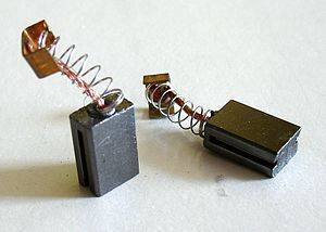

Hello,
Im using DC motor to run the conveyor but suddenly the armature shows high current 130 A for 30 V power and the speed can't increase anymore. The motor power stated in the name plate is 93.8 KW, Armature voltage is 453 V and Armature ampere is 225 A. The motor can run free load after disconnected from the load but fail to run on load. We have checked the field coil, armature coil and the brushes . The are no insulation damaged since it can be run free load.
What are the possible causes to the motor that fail to run on load? Is it because not strong magnetism or another mechanical failure?
