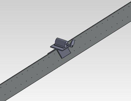

Hi guys,if i mount a dc motor on a glider that slides in 2 directions without friction, AND, instead of having it drive a mechanism, have a circular plate with an eccentrically drilled hole in it (not centre) mounted on the motor shaft though this hole, i should observe the glider sliding back and forth in a frequency, shouldn't i? In a vibrational manner?Ok, so I am going to apply this to my final year project as an experiment which can be conducted by students, and the students can attach circular plates of different mass, to figure out the vibrations that it causes! The distance that the glider travels back and forth will be experimentally measured with a keyence laser i will mount one the end of the airtrack, but the students will also have to theoretically calculate the vibrations too.
to clarify,its my final year mech eng project to create an airtrack for various experiments to be carried out on.
can you guys point me in the right direction in terms of equations to explain this? I need show the theory behind this obviously and calculate it myself to put in my report.

If I'm understanding your description correctly, yes you should. What you're effectively doing is having it shift the center of mass of the system. It will "try to correct itself" by exhibiting reaction forces on the rest of the system to keep the center of mass constant.
Based on what geometry you're using it might be somewhat difficult for the students to theoretically calculate the vibrations, so I'd say try to keep it relatively simple. But it'd definitely be a good idea to mock-up a solid model in Inventor or SolidWorks to show us better what you're talking about.
I strongly suggest that you make some calculations before the fact. You may be disappointed with the small amplitude of motion at any but the very lowest frequencies. You can save your self a lot of trouble by making some design calculations ahead of time on this.

Adamxrt: The reason I suggested you make calculations before you choose a motor is that the calculations should guide your choice of motor. What you will find is that motor rotor and frame weight have a major impace on the motions you will see.
You need to write F = m a for the motor frame and for the unbalanced rotor. You can include a variable frequency excitation on the motor and see where that leads you.
You will also have to give some thought to the matter of how you will react the motor torque on the frame. What will stop the frame from simply spinning in the opposite direction?

Specifically, the motor frame is the non-rotating exterior part of the motor. For the purposes of this experiment, you should perhaps think in terms of adding to that any additional mass that you mount to the motor. That applies to both AC and DC motors.
The holes that are already there, drilled and tapped are provided for mounting purposes.
Think about conservation of angular momentum. The electric current generates a torque on the rotor, but there is an equal and opposite torque on the stator (in the frame) by Newton's third law. What are you providing to react this reaction torque? I don't know because you have not given a very clear image of what your set up will be. From the mental image I have, the motor frame could spin one way while the rotor spins the other way, at least until the power cord tangles completely. That's why I asked the question.
Thanks for the help so far man. Take a look at the attached image. This is a basic mock of the setup i envisage.
That makes it clear that there will be no tendency for the motor frame to spin. Carry on, and good luck.

My goal is to calculate the maximum linear displacement of the centre of mass of the whole glider plus motor system through one revolution of the shaft.

Sorry guys, this just got brushed under the carpet because i got it to work in solid edge dynamics motion simulator. but i still have to show the calculation either way.
I've settled on a small vibration motor commonly found in dualshock controllers and, forgive me for saying it, womens vibrators. it provided a data sheet which I am going to link below.
https://catalog.precisionmicrodrive...asheet/312-107-12mm-vibration-motor-15mm-type
go to the calculation section and it gives the vibration formula I am going to use. I just have one problem with that formula...k, the sytsem stiffness...having just ploughed through my engineering dynamics textbooks i see a similar set of problems to mine, but they all involve fecking springs or something of the like for which it is easy to give a value for k.What do i have in mine? Should i put k to 0? or 1? what?
Wouldn't it be a good idea for you to try writing the equations of motion for your system yourself, rather than simply assuming that you should use something you found on a data sheet? The system described on the data sheet does not really look like your system, so why would you expect that equation to apply to your case?
Its because i tried writing them and failed horribly. I went back to my porject supervisors and they wanted to see the motor id selected. I went back, selected a motor and saw that on the data sheet. brought it back to them and said, is this by any chance the equation i should be using? they said it was very similar. they then directed me to a question in my textbook which is supposed to be nearly identical to mine, and said try look at how this question is solved...
they sent me the solution and it uses the same formula.
I completely appreciate your suggestions though man, its just i aint got nothin. Vibrational dynamics has never been my strong point. That equation gives the displacement from the centre of rotation. The k value is what's stopping me. In the textbook, that question had k a k value, but they managed to pull that from a spring.

i can fill every other variable in that equation with a number, except for maybe Wn, I am not so sure how to figure that out either.
i should also say that this is classified as a "forced vibrations" problem, and that this equation fits that category.EDIT: Just to clarify aswell, i think that system on the data sheet does apply, because they have fixed their motor onto a test right with and accelerometer and they are measuring its amplitude. Its very similar.
i have mine fixe don a glider on a frictionless surface, and i think, i want to figure out its amplitude in the 1 degree of freedom (travel along the track).
I managed to get it simulated in solid edge! ill try and upload the animation.EDIT 2:motor animation
