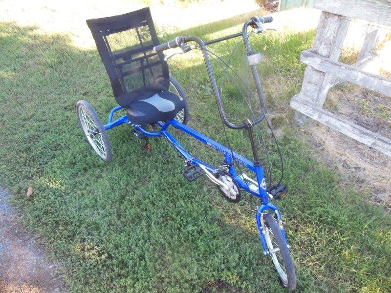

So I am wanting to build several tools, rock saw,belt sander,wood lathe with a variable speed. Also rig up my trike for electric power that has the potential to be charged with solar panels. looking for 0.5HP-2.5HP max.
What voltage motor and controllers would be the sweet spot so I can use the same motor and control on all my tools and contraptions so I can keep some continuity of component?. making the parts all interchangeable so I don't have a mix . A voltage I could swap power from a solar or grid for direct power or run on battery power.
I find the right motors and controls I will buy 6 or so to make my projects and have spare parts.
This is my bike I would like to turn into a solar charged electric/pedal bike.

A big part of the decision here will be economic - for example good options for motors are: Treadmills, (90-150VDC), Car starters (12V), golf carts (probably too big - but 36 or 48V) - I have electric lawnmower with 36V motor, fuse is 25A - so the motor is probably ~ 15-20A rating. (I was toying with the idea to build a speed controlled for this, but a 15A inductor was looking expensive.)
Then batteries size, weight, running time - etc. Lead Acid are available and cheap, but bulky and heavy - LiPO $$$... and harder to charge if you do not buy a preconfigured set. ( like RC Car batteries -) - A trike can carry weight better than a bike - so I would lean to LA. Also -- LA may be better to build and tst on and then if it works well - upgrade the batteries to LiPo for the ones that matter.
