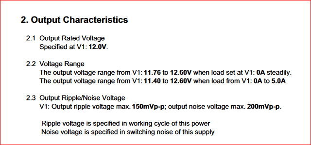

Many regulated power supplies require some minimum load current , below which their voltage will rise somewhat.
This note on your supply's datasheet at https://www.jaycar.com.au/12vdc-5a-dc-output-regulated-power-supply/p/GH1379
MPORTANT!
This power supply is not intended for powering sensitive electronics such as surveilance cameras. For powering sensitive electronics, please use our MP-3242.
suggests to me it is not a precision supply.
You might try giving it a small load, like a small 12 volt bulb
or try another supply

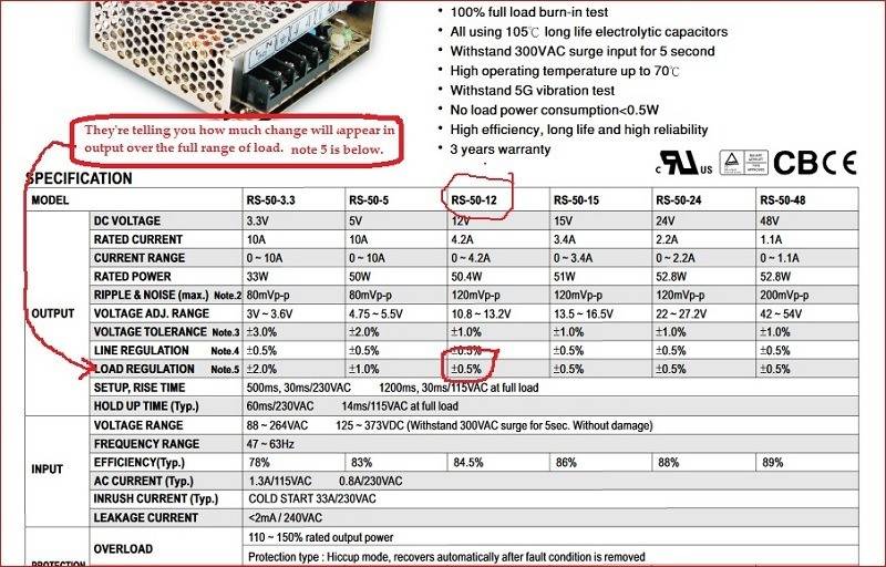

this one is about fifteen bucks on Ebay, specs say 0.5% load regulation which would be +/- 60 millivolts .
http://datasheet.octopart.com/RS-50-12-Mean-Well-datasheet-10901130.pdf
http://www.ebay.com/itm/RS-50-12-Me...132323?hash=item1c759a52e3:g:q3cAAOSw5cNYL7BO
if this is a for a medical application play it safe and use one of the medical rated supplies.
if this is a for a medical application plat it safe and use one of the medical rated supplies.

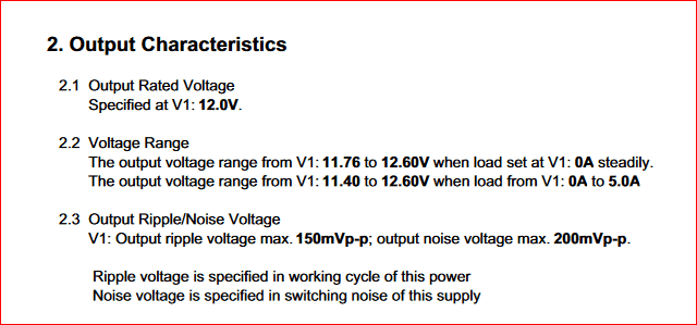

I had no idea there was precision and non-precision when it came to regulated, I thought it was either regulated or not...
I went back to jaycar and bought what the non-precision one recommended for precision use (this one) and...it works!
The data sheet says it won't drop below 11.4V at full load.
It gives 12.3V open circuit, and my motors do drop the voltage, but it never goes below 11.6V.
A single motor will run at 12V, more than one seems to have it between 11.8-11.6V.
Knowing this when I plug everything back up to the microcontroller I can program in 2 timings, one for if a single motor is running, one for if multiple motors are running (0.2V difference between 2-5+ pumps is negligible in this case.)
their "spec sheet " is mighty sparse.
Here's a snip from a more typical one, for that Meanwell .
Load regulation is % voltage change for a 100% load change and tells you how precise is its regulation. Lower number = tighter regulation.
Have fun !
Aha ! Found it!
spec sheet for your new 3242
https://www.jaycar.com.au/medias/sys_master/images/h65/h9b/8855997841438/MP3242-dataSheetMain.pdf
looks like it's got 5% regulation which is ballpark of what you measured
jim hardy said:
Aha ! Found it!
Been using it all day and it's going great! Thanks again.
