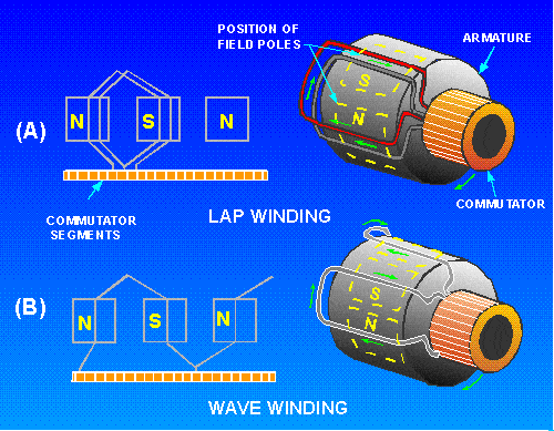

Thanks Jim. Even with those figures I found it a little hard to picture what was going on, but you gave me a term that I could google ("lap winding") and I found these images helpful:
(From this page.)
(From here.)
Still a little mystified by the wave winding scheme. It seems to me that adjacent loops produce fields that more or less oppose or cancel each others field. But it works, so obviously I am missing something.
