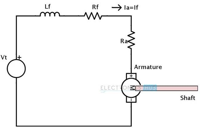

lets assum we have a load fixed on the roter of a the 'DC series motor' in the attached photo, where:
Vt: DC source voltage (constant)
Lf: field's inductive resistance (will be neglected)
Rf: field's resistant
Ra: Armature resistance
Ia= Armature current, If: field current
M: back emf (Ea)
and the related functionl equation is:
kQw (Ea)= (Vt-Ia(Ra+Rs)/kQ ; //Q:flux
Now, if the load is doubled, then by applying kerckhoff laws, the armature current must be reduced. Anyhow, this seems to me contradicts with this motor characteristic of which that current increases as torque or load increases (kindly find the second attached photo), in other words: Torque = KQI.
Its really confusing! I spent one day trying to sort it out uselessly.
Appreciate your help to understant this.
How?
Likes peter010
cnh1995 said:
How?
I am presuming or imagining the load as an extra resistance RL in the circuit. Once this resistance get doubled in the circuit, the current will be affected inversely.
If this approach does not make since, then kindly how it should be, or what will happen if I doubled that load?
regards
If you increase the load, the speed of the motor will drop. What will happen to the back emf? Supply voltage and rotor resistance are constant.
Likes peter010
back emf will drop down and thus geting more current in the curcuit. AWWW
Thank you very much :)))))))
I would also point out - if you double the resistance in a circuit you are not "doubling the load"
P = V2 / R -- double R and you cut the Power in half.
To double the load - for a fixed voltage you need to cut the resistance in half - and / or think - adding another resistor in parallel - that is truly "doubling the load"

Acually, now i am discussing it please from another perspective, what if I used a pulse width modulation device to reduce the main votage to a certain limit, let's say Vnew=70% Vold. What will happen to the back emf? Can I then predict or calculate precisly the value of back emf at same load ?
PWM uses a pulse rate sufficiently high that the motor speed doesn't measurably change during the power ON and power OFF intervals.
Back emf in a series DC motor is a function of both (i) rotor speed, and (ii) field strength. Although the applied voltage is being pulsed ON and OFF, inductance of the rotor-field path should see this current held approximately constant, with its level decreasing as the controller lowers the speed.

peter010 said:
I tried to figure this out, but i could not predict or calculate the new value of the current since i can't depend then on the original characteristic chart of this motor.
you are aware that because the field is in series with the armature ,
flux is a function of armature current
and i can't tell by inspection whether you accounted for that in your equation
What's Q ?
the two basic equations for a DC motor are
counter EMF Ea = KΦRPM,
Torque = (same)K X 7.04 X Φ X Iarmature , torque in foot pounds
so
Torque = K X 7.04 X Iarmature2 X K' , where K' relates Iarmature to Φ (which inductance does nicely if you know #turns)
i think you'll have to find K and K' by a curve fit ?

Thanks for responding
Actually, I can best describe my case by saying: After reducing the source voltage, I have then two unknowns: the current and the EMF.
[Before reducing the voltage, I was able to identify the current value for my motor's circuit from this motor's characteristic graph, but after reducing the the source voltage, the characteristic graph is not applicable any more and thus I can't use it to identify the new current value]
So, that is, how to solve the circuit for the two unknowns?? :)))
Can you post a clear photo of that graph?
i see two equations and two unknowns...
