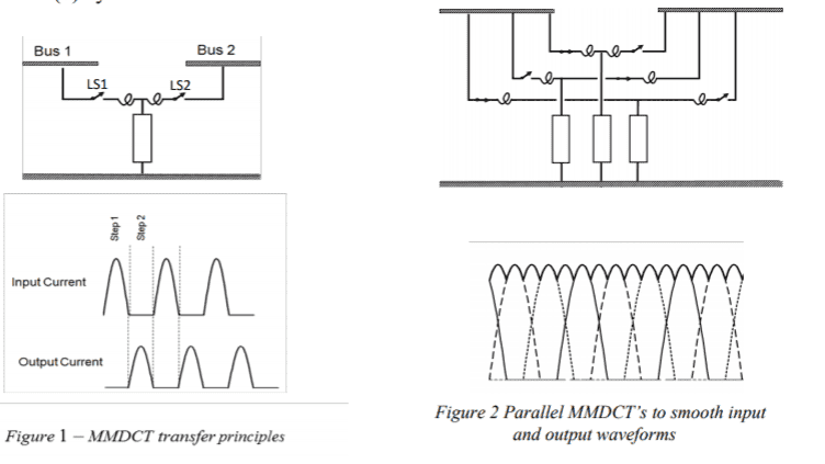

The basic element is a "column" which is a collection of a large number of capacitors in series, with a bypass switch around each capacitor. Connect the column to the high voltage side and the capacitors charge up. Now disconnect the high voltage side (all switching is done at current zeroes), bypass some of the capacitors and connect the column to the low voltage side. But that's unstable, because on the next cycle the capacitors don't begin with equal initial charges. The solution is to choose different subsets of the capacitors for each half cycle. That is called the "sorting" solution for charge equalization. None of the capacitors ever get fully discharged. With a large number of capacitors to choose from, you can do a lot of smoothing. The switching frequency is as high as possible, limited by switching speeds. Also throw in a little L to charge resonantly.

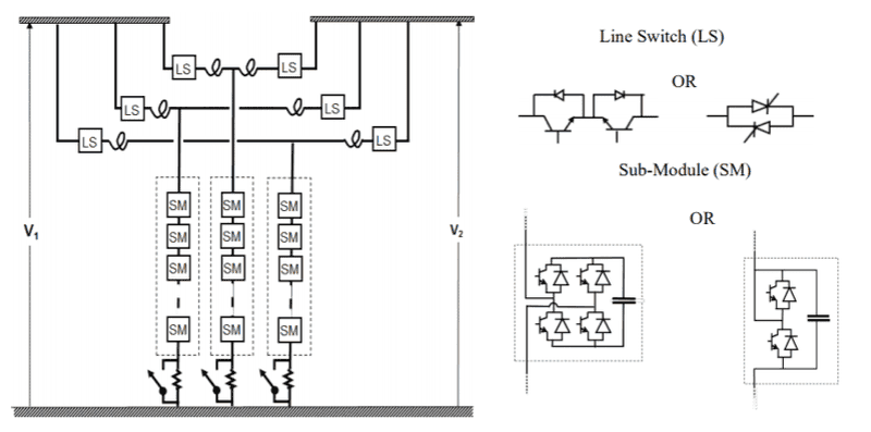

The scheme is shown below. One "column" on the left and with three parallel "columns" on the right. The three columns help smooth the current. (Don't get confused, this is not three phase power, it is three DC devices in parallel.)
Here's a schematic showing details of the switching electronics.

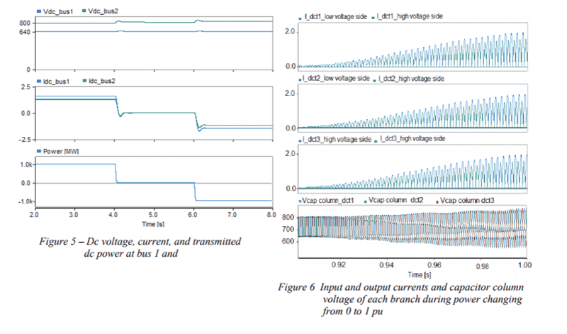

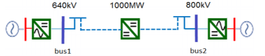

Here's a little simulation. We have a 640KV bus, 200 km of HVDC line, the transformer, another 200 km of line, and an 800 KV bus. The transformer has 400 submodules in each column. Switching frequency is 400 hertz.
The simulation shows a transient, +1000 MW transfer, zero MW, then -1000 MW, in only 6 seconds. demonstrating bidirectional power flow with the same bus voltages. The transients show below are at the transformer. The currents have an enormous amount of ripple, but it is high frequency. At the bus ends of the lines, the ripples are largely filtered out by the inductance and capacitance of the 200 km of line, so that the DC looks fairly smooth.
