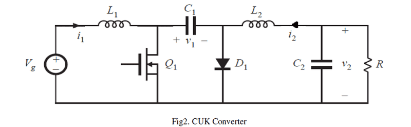

Assuming that a CUK converter is operating in DCM mode (see attached image), find the solution for M(D,k). D is the duty ratio of the switch, and k...

The sad part is, I already have the solution guide with a semi-decent walk-through, but one part of it is really confusing me. My confusion may come from doing the problem incorrectly, so I'll go through my entire work just incase. All of our analysis has used small capacitor ripple approximation and circuit averaging.
The first subcircuit (From time 0 <= t <= D1*Ts) has the switch closed and the diode opened. Describing the inductor voltages and capacitor currents:
[tex]V_{L1} = V_g[/tex]
[tex]I_{C1} = -\frac{V}{R}[/tex]
[tex]V_{L2} = -V_{C1} - V[/tex]
[tex]I_{C2} = I_{L2} - \frac{V}{R}[/tex]
The second subcircuit (From time D1*Ts < t <= (D1+D2)*Ts) has the switch opened and the diode closed (saturated). Describing the inductor voltages and capacitor currents:
[tex]V_{L1} = V_g - V_{C1}[/tex]
[tex]I_{C1} = -I_{L1}[/tex]
[tex]V_{L2} = -V[/tex]
The third subcircuit (From time (D1+D2)*Ts < t <= Ts) has both the switch opened and the diode opened. The current through the diode has tried to go negative due to the inductor current ripples and low DC offset, thus it turned off.
[tex]V_{L1} = 0[/tex] Is this correct??
[tex]I_{C1} = -I_{L2} = I_{L1}[/tex]
[tex]V_{L2} = 0[/tex] Is this correct??

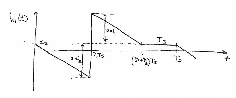

This where I would write an equation for the average, set it to zero, and start trying to eliminate D2. BUT, in the solution, it is shown that there is a DC offset in the capacitor current (see attached image).
I don't understand where the DC offset of I3 came from, or why I should have known that.
Could someone please explain this to me.

I think I see my mistake now. In my subcircuit equations, I simply put things in terms of inductor currents: IL1 & IL2.
Each of these actually need to be broken up in an AC and a DC component. I can calculate the AC component by integrating the voltage waveforms of the inductors, but the DC components just need to get carried through the simultaneous equations as an unknown variable. It turns out that both inductors have the same DC component, because in subcircuit 3 they are the exact same current. This DC component is what he labeled as I3.
I believe I can now solve some simultaneous equations to get all unknown values.
