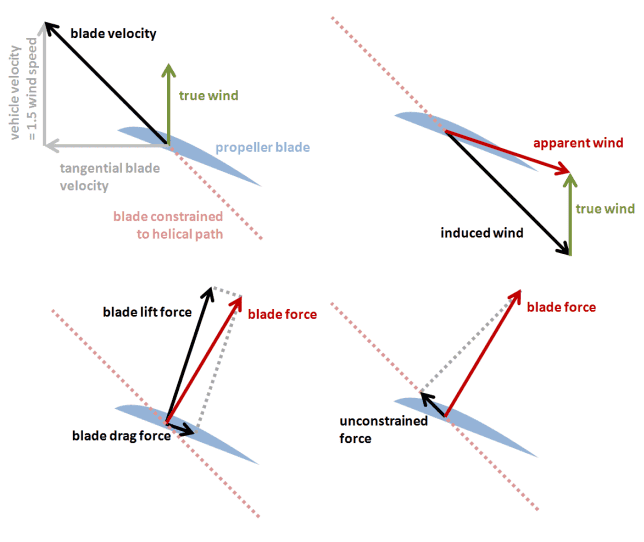

Getting back to the least confusing explanation of a a vehicle that interacts with two media (for this case air and ground) with a relative velocity (true wind speed from the ground frame of reference) ... One explanation focuses on the effective gearing used to reduce the speed and increase the force from the faster moving media (ground if moving DDWFTTW, air if moving DUWFTTW) to be applied to the slower moving media, which is used in the articles you linked to that discuss the process from a power perspective, which are similar to Mark Drela's analysis (link below). Another explanation uses tacking as an analogy, which is somewhat different in the case of a single land yacht (which is why I don't like tacking analogy). However, in the case of a two land yacht vehicle, the same effective gearing effect is involved, the net force on the vehicle from the sails that interact with the air is downwind and the net force on the vehicle from the wheels (acting like keels) that interact with the ground is upwind, and from the vehicles frame of reference, the gearing is used to reduce the speed and increase the force from the faster moving media.
Mark Drela's analysis:
http://www.boatdesign.net/forums/attachments/propulsion/28167d1231128492-ddwfttw-directly-downwind-faster-than-wind-ddw2.pdf
Here is the simplest explanation I've been able to come up with:
Suppose the cart is moving at the same velocity as the wind. Then there is no drag force. If we can neglect rolling resistance and friction in the axles, then the only horizontal force on the cart is in the forward direction and due to the propeller pushing backward on the air.
Since the force on the cart is in the forward direction, it will accelerate and go faster than the wind.

No. Even without those dissipative loses, there is still a drag force at the wheels, which have to turn the propeller against the aerodynamic torque. The key here is the difference in relative speeds (ground-cart vs. air-cart), which allows this drag force to be lower than the propeller thrust.

Rick Cavallaro, the pilot of the Blackbird on the record runs, offers his favorite explanations in this talk:
As a kid i played with a spool and was fachinated abaut the fakt that the spool came closer too me even when it meant that the thred was winded up on the spool. There you have the force aspect in this matter.
Imagine you are in a train with no floor.
Put down a wheel, driven by the moving ground beneth, that with a transmission drives you forward in the train with apropiate equippment.
The moving train itself makes you travel faster then the train, like the wind itself makes you move faster then the wind.
The air and the ground are moving relative to one another, therefore, they have kinetic energy relative to each other.
It is possible to build an apparatus to harness that energy.
Movement of the apparatus parallel to the air/ground movement necessitates certain design considerations, but does not invalidate the possibility of capturing energy from the air/ground movement.
Energy, from whatever source, including that described above, can be used to propel the apparatus.

Vanadium 50 said:
1. Consider a cart with a sail, going exactly as fast as the wind. Do the wheels have to be frictionless? The answer is no, the requirement is that the thrust from the wind is equal to the drag from air plus from the wheels. If I have more wheel friction, I need a larger sail, to be sure. Agree?
At exactly wind speed (going parallel to it) the force on the sail would be zero, no matter how large you make the sail. So a passive sail cart could only stay at windspeed if the drag from the wheels was zero. For a non-zero drag you can approach windspeed from below by making the sail larger, but never quite reach it.
Vanadium 50 said:
You are riding in this cart at the speed of the wind, and the brakes are partially engaged. What happens when you release the brakes? The answer is - nothing.
Not nothing. It would get closer to windspeed.
Vanadium 50 said:
3. Now we put the two together. The wheel brakes are taken from a Toyota Prius, and so generate electricity. I remove the battery and use this electricity to power my electric fan. And there we go.
As @jbriggs444 points out: This will only work if the fan produces more thrust than the wheel drag needed to power the fan. And the key point that makes this possible is the difference in cart-relative-velocity of ground and air, as the video mentions briefly.

A.T. said:
Derek just added a pinned comment to emphasize this point:
"The key is that we're harvesting power at higher speed, lower force, and deploying it at lower speed, higher force (which is only possible because we have a tailwind - in still air this wouldn't work because the relative velocity of the wheels over the ground would be exactly the same as the relative velocity of the prop through the air)."
This also works for upwind faster than the wind. A propeller like windmill is used to drive the wheels, harvesting power from the air at higher speed, lower force, and deploying it to the ground at lower speed, higher force. The Blackbird was modified to do a DUWFTTW run.
I don't like the propeller acting as a pair of tacking sailboats analogy, as the key is interacting between two media moving at different speeds with respect to each other. A propeller just happens to be an efficient way to generate thrust. There is also a significant difference. At high speed on a tacking sailboat, the apparent wind is almost a headwind (small Beta angle), and most of the lift force is perpendicular to the boat, coexistent with an opposing force from the water | land | ice, with no contribution to the boats speed, and only a small component of the lift is in the direction of the boat's heading that contributes to the boats speed. For the blades of a propeller, the apparent wind is even closer to a headwind, but in this case, the lateral component of lift is contributing to almost all the thrust, while the "forwards" direction of lift and drag combine to produce a rotating air column behind the propeller.
In the case of a geared device interacting between two moving surfaces, power losses aren't an issue, and there is nothing that could be construed to be similar to tacking. Similar to a DDWFTTW cart, the gear ratio is setup so that table speed is greater than ruler speed, resulting in the cart moving under the ruler faster than the ruler. Skip to 1:47 into the video to see the movement.
This concept isn't new. It was used in the 1877 Brennan Torpedo. On the dock, there were two steam driven spools that pulled in wire, while on the torpedo, there were two spools that geared down and drove a propeller as the wires were unspooled. Same principle, power is harvested from the wires at higher speed, lower force, and deployed to the torpedo propellers at lower speed, higher force. If the wires were instead attached to posts on a bridge above a stream, then a Brennan Torpedo would move downstream faster than the stream.
https://en.wikipedia.org/wiki/Brennan_torpedo
As noted in Veritasium's video, there's also another requirement. From a ground frame of reference, the true wind has to be slowed down in order to provide an energy source, which occurs due to the backwards thrust from the DDWFTTW propeller. From the cart's frame of reference, the surface of the Earth is slowed down a very tiny amount (huge mass), in order to provide an energy source, which occurs due to the forward force the wheels exert on the Earth's surface.
