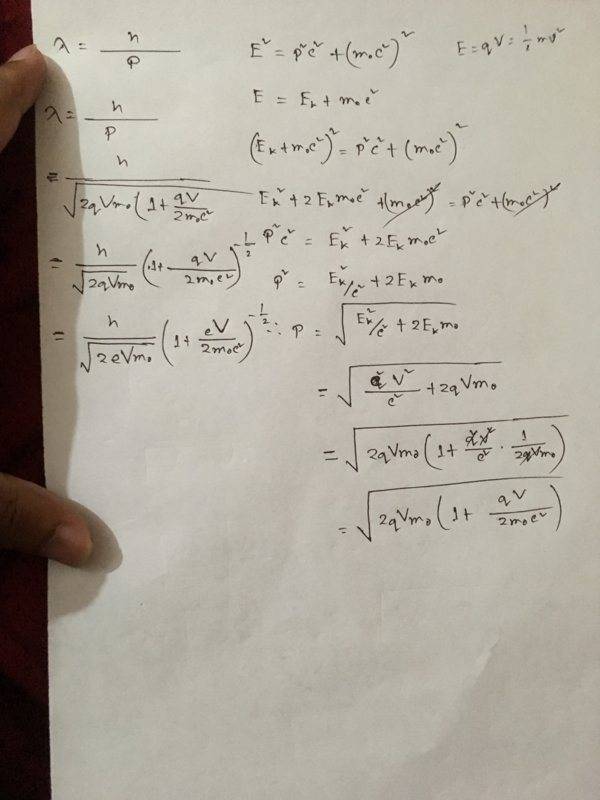

Problem:
Derive a formula expressing the de Broglie wavelength (in Å) of an electron in terms of the potential difference V (in volts) through which it is accelerated.
Solution (so far):
The textbook's answer is the following,
[itex]\lambda=12.27[V(\frac{eV}{2m_{0}c^{2}}+1)]^{-\frac{1}{2}}[/itex]
I'm having some trouble getting there. I started by noting that if an electron is accelerated from rest through a potential difference V, it gains a kinetic energy
[itex]\frac{1}{2}mv^{2}=eV[/itex]
So therefore,
[itex]v=\sqrt{\frac{2eV}{m}}[/itex]
Since [itex]\lambda=\frac{h}{mv}[/itex]
Therefore, [itex]\lambda=\frac{h}{\sqrt{2meV}}[/itex]
Also, [itex]\frac{h}{\sqrt{2me}}\approx 12.27 Å[/itex]
So I get, [itex]\lambda=\frac{12.27Å}{\sqrt{V}}[/itex]
I don't know where I went wrong. Any suggestions?
Relativity?

I think you should start by writing down the energy relativisticly.

In relativity, kinetic energy is [itex] T = \gamma mc^2 - mc^2 [/itex]. Momentum is [itex] \vec p = \gamma m \vec v [/itex], where [itex] \gamma = \frac{1}{\sqrt{1 - \frac{v^2}{c^2}}} [/itex].
By the way, when I say [itex] m [/itex] here, I mean the same thing as [itex] m_0. [/itex] I don't distinguish "mass" from "relativistic mass". Most physicists don't these days. Mass is the rest mass, period. If you prefer, kinetic energy is [itex] T = \gamma m_0 c^2 - m_0 c^2 .[/itex]
[Edit: by the way, if you're curious, if you take the Taylor series expansion of [itex] \left( \frac{1}{\sqrt{1 - \frac{v^2}{c^2}}} \right) m_0 c^2 - m_0 c^2 [/itex] around [itex] v \approx 0[/itex] you'll find that it reduces to the Newtonian [itex] \frac{1}{2} m_0 v^2 [/itex] for [itex] v [/itex] near 0. Neato.]

As for the problem I originally asked, if anyone is interested, I obtained the required solution by the following:
Begin with (pc)^2+(E_0)^2=E^2
Solve for p and substitute the result into the de Broglie wavelength equation λ=h/p.
Next, eliminate E by introducing kinetic energy, then use the fact that K=eV.
Simplify and be sure to express the constant quantity h/sqrt(2em_0) in angstroms (≈12.27Å).
No thanks to voko or collinsmark! - Just kidding, at least you tried to help. :biggrin:
Also, it's interesting to note the result reduces to the equation I derived first incorrectly in the event V << c^2.

I have solved it, like this
