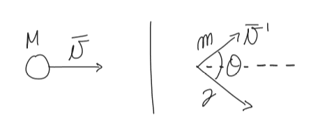

An excited atom of mass ##M## moving with velocity ##v## in the laboratory system decays into a state of mass ##m## by emitting a photon.
Calculate the relationship between the final speed ##v'## of the atom and the angle ##\theta##, formed by the directions of flight of the final particles.

The information I have are the following:
##p^\mu=(E, p, 0, 0)##
##p'^\mu=(E', p'\cos\beta, -p'\sin\beta,0)##
##k^\mu=\tilde{E}(1, \cos\alpha, \sin\alpha, 0)##
Where:
##E=\sqrt{M^2+p^2}##
##E'=\sqrt{m^2+p'^2}##
Using the conservation of the four-momentum
##p^\mu=p'^\mu+k^\mu##
##(p^\mu)^2=(p'^\mu+k^\mu)^2##
##M^2=m^2+0+2(E'\tilde{E}-p'\tilde{E}\cos\theta)##
##\frac{M^2-m^2}{2(E-E')}=E'-p'\cos\theta##
##\frac{M^2-m^2}{2E'(E-E')}=1-v'\cos\theta##
Now I should replace the values of ##E'## and ##E##, but I don't know if this is the correct way, after that I would have all the roots of their definitions and I would have to rework the formula to write ##v'## as a function of ##\theta##, ##M##, ##m## and ##v##.
What do you think?

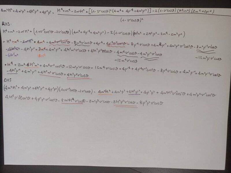

Why do not you proceed to get formula of ##v'(\theta,M,m,v)## first then investigate it ?
I tried, but the more I go I get lost in the accounts. I'm not even rewriting what I wrote here on the forum because it seems to me just a waste of time, but to show that I tried to do the math I am attaching the spreadsheets.
As this is an exam to be done along with 2 exercises in 2 hours, it's strange that I have to lose myself in so many accounts.
