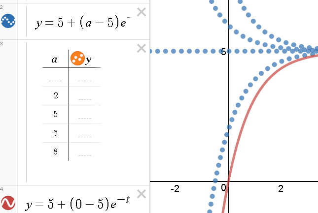

I would use a Desmos slider:
[DESMOS]advanced: {"version":5,"graph":{"squareAxes":false,"viewport":{"xmin":-10,"ymin":-10,"xmax":10,"ymax":10}},"expressions":{"list":[{"type":"expression","id":"graph1","color":"#2d70b3","latex":"y=5+\\left(a-5\\right)e^{-x}","style":"SOLID"},{"type":"expression","id":"2","color":"#388c46","latex":"a=0","hidden":true,"style":"SOLID"}]}}[/DESMOS]
Now, manually move or animate the slider to see how the solution behaves for differing values of the parameter.

so multiple graphs would just be $y(1) \quad y(2) \cdots$ for $y(a)$ ?

I'm not sure I know what you mean. If you want multiple graphs, you could just define them like this:

[DESMOS]advanced: {"version":5,"graph":{"xAxisLabel":"t","yAxisLabel":"y","squareAxes":false,"viewport":{"xmin":-10.72837090838311,"ymin":-10.471822929382325,"xmax":10.52162909161689,"ymax":10.778177070617675}},"expressions":{"list":[{"type":"expression","id":"graph1","color":"#2d70b3","latex":"y=5+\\left(0-5\\right)e^{-t}","style":"SOLID"},{"type":"expression","id":"2","color":"#388c46","latex":"y=5+\\left(10-5\\right)e^{-t}","style":"SOLID"},{"type":"expression","id":"3","color":"#fa7e19","latex":"y=5","style":"SOLID"},{"type":"expression","id":"4","color":"#6042a6","latex":"y=5+\\left(-5-5\\right)e^{-t}","style":"SOLID"},{"type":"expression","id":"5","color":"#000000","latex":"y=5+\\left(15-5\\right)e^{-t}","style":"SOLID"}]}}[/DESMOS]
You can use \(t\) as the independent variable, and even label the axis, as you see above.
