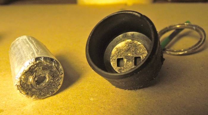

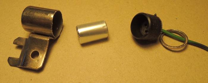

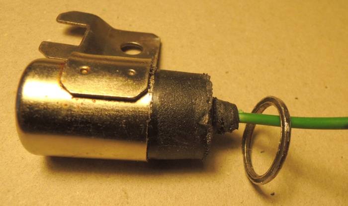

I performed an autopsy on the brand new Autozone Duralast condenser that seems to have failed and found some damning badness inside. Here is some photographic documentation of the procedure:
I cut the rolled over "lip" off the can off with a hacksaw. That's the ring around the green wire. Once that's off, I pulled out the rubber plug which insulates one end of the condenser. That's the black thing the green wire goes into.

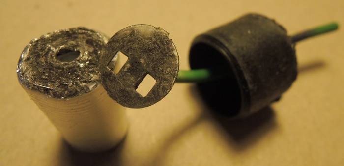

Pull the rubber plug all the way out, and out drops a little silver "soup can" looking type thing. That is the condenser plates, all rolled up. Notice they are not soldered to anything, or even mechanically connected in any way.

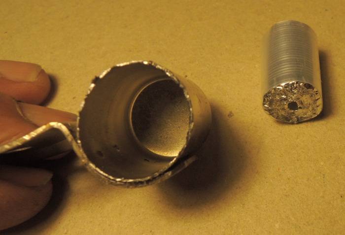

Here is a shot of the inside of the can and one end of the condenser plates. They are clean and shiny: no problems here.

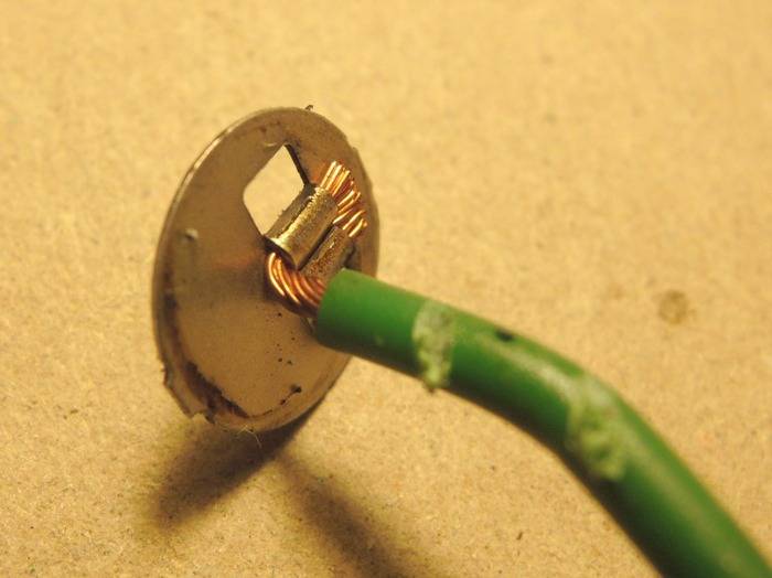

Here is the other end of the plates and the steel contact that is what is on the inside end of the green wire. These don't look so good.
Close up of above elements. You can see this is where the condenser fried. There has been a lot of high voltage sparking between these two things.
This is how the steel contact plate is attached to the green wire.

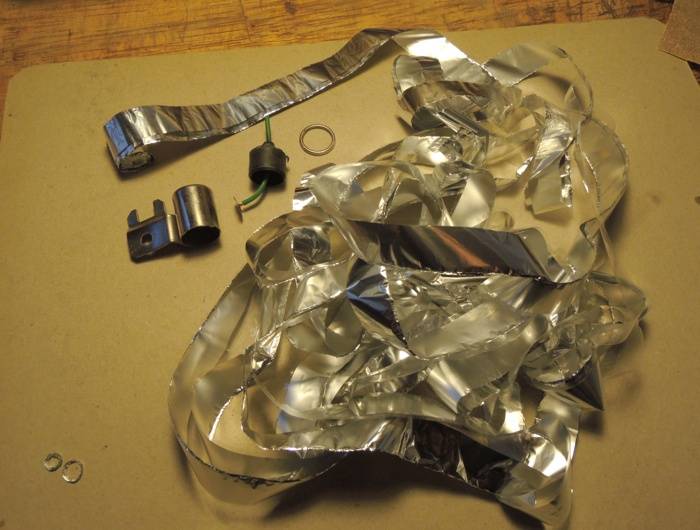

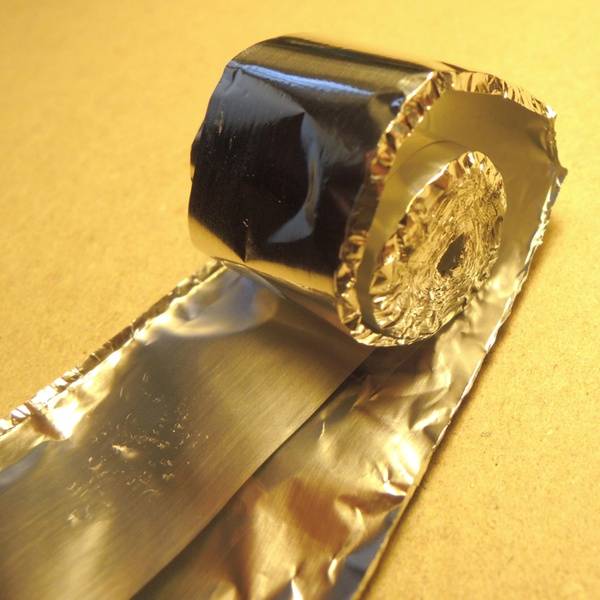

Starting to unroll the condenser plates. The plates are, as far as I can tell, common aluminum foil. I miked one and it is about .0003 thick. The clear plastic insulation between the foil is about .0005 thick. There are two layers of foil and two layers of plastic. The two layers of foil are offset from each other: one sticks out about 1mm on one side, the other about 1mm on the other side. Once they are rolled up, the excess that is offset is just crushed to the bottom on the can on one end of the roll, and to the steel contact on the other end of the roll.
Here's all the intestines unrolled. I didn't find any evidence of sparking or burning inside; no insulation breakdown between the plates.
The aluminum foil (one plate or layer) is about .670 wide and about 137 inches long. That's an area of 91.79 square inches. It would be a square measuring only about 9.5 inches on a side (though it seems like it'd be larger than that from the pile you see.)
So, what this autopsy reveals is that this is very old, uncomplicated technology. The basic design of these condensers prolly hasn't changed since the 1930's when the car was first designed. Now they use plastic to separate the plates. Back then they used wax paper. It ain't no kind a fancy.
Why did it fail? I don't know. Maybe it was just manufacturing procedure: the rubber insulator wasn't pressed in far enough, leaving a poor contact between the steel and aluminum, inviting a spark to jump and burn the metal. That's plausible, but really just speculation.
