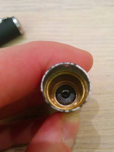

I’m looking to demonstrate destructive optical interference using a laser pointer. I’m splitting the beam with a prism and projecting the beams onto one point on the wall. Somehow I’m failing to get any effect, however.
Setup:
1. I’m using a static laser pointer, a prism and a handheld mirror. The laser is at 0cm, the prism is at 7cm, the mirror is at 3cm (between the laser and prism out of the way of the original beam), the wall is at 15cm.
2. I’m pointing the laser dot through one side and using the internal reflection to project the dot through another prism face onto a wall.
3. I’m using the part of the light that reflects back from the prism and reflecting it into the dot on the wall using a mirror. The reflected beam is weaker than the one from the internal reflection, but it has good focus and decent intensity.
4. I’m observing the projected laser pattern when the two dots meet. I don’t have an expectation to see an unchanging cancellation or interference pattern, but I do expect to observe changes, fringe patterns, flickering or vibration in the projected dot when the two beam projections meet.

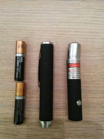

Equipment:

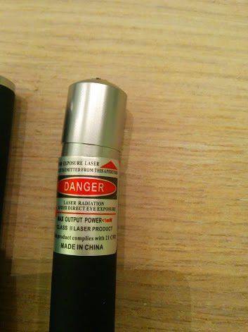

i. Red laser pointer
The laser was purchased from http://www.amazon.com/gp/product/B0051223CU/?tag=pfamazon01-20. The pointer emits a red dot that (viewed very closely) seems to have a sparkling effect with lots of tiny-tiny dots. Its focus point is about 4mm, the focus at three meters is the same (or no more than 1-2mm larger), the focus at 25m is small as well - somewhere between the original 4mm and definitely not larger than a few cm. The label warns of eye exposure, declares compliance with 21 CFR and says the power is less than 1mW. The website says the wavelength is 650nm. It seems to be a genuine laser pointer. When doing the hair experiment and moving it in into the beam, I do see some sort of patterns indicative of interference.
ii. Glass prism
The glass prism is from http://www.amazon.com/gp/product/B00BNSU7FQ/?tag=pfamazon01-20. It reflects from the inner surfaces and reflects back to the original source.
iii. The mirror is http://www.amazon.com/gp/product/B003EB57MI/?tag=pfamazon01-20 (acrylic safety mirror). It’s not of the highest optical quality, but it does reflect well (the loss is less than from splitting the beam using the prism).

  • labels on laser
  • view into the pointy end of the laser, the diode lens being visible
  • components

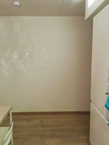

  • focus point size at 3m

So you expected to see fringes, or what? The problem might be because the fringe separation is either to small or to big. What about placing a diverging lens several cm just before the wall? And making the mirror stand still is also recommended.
I did expect to see a change in the laser dot. Mostly I expected fringes that flicker due to small vibrations in my hand (fringes along the lines of (along the lines of https://upload.wikimedia.org/wikipe...son_Interferometer_Red_Laser_Interference.jpg or https://web2.ph.utexas.edu/~phy-demo/demo-gifs/6d40_10a.jpg).
When waiting tens of seconds, there moments be times where hand microvibrations settle enough to change less than 0.03mm per second, which would correspond to 50x the wavelength and therefore <50Hz vibrations. That should be perceptible to the eye in at least some form.
I can use a lens to magnify the picture, but given that I'm seeing other artifacts in the dot pretty well, I doubt I'll see more when magnifying the lens. Since I don't merge the beams until they hit the projection screen, it'll also be difficult to merge the beams at the lens.
Just off the top of my head, I think the bandwidth of the laser pointer is too great.
destructive interference means the waves are 180 degrees out of phase,
I don't think the laser diode photons are in phase enough for you to see much effect.
Try setting up some feedback, like pointing the beam straight into a mirror.
Feedback? What should pointing it into the mirror do? Apologies, can you elaborate?
The laser diode has a very short cavity length, and supports many optical modes.
Interference would be from one mode interfering with itself.
Pointing it into a mirror could isolate off whatever mode stands in the new,cavity length.
Lauri said:
I’m looking to demonstrate destructive optical interference using a laser pointer. I’m splitting the beam with a prism and projecting the beams onto one point on the wall. Somehow I’m failing to get any effect, however.<snip>
That will never work. You need to first spatially filter the beam to increase the transverse coherence length.
