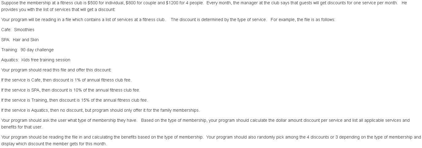

Working on an I/O assignment and I'm running into some logic errors. I was wondering if I could get a quick break down (not necessarily code, but the pseudo code behind some of these points I'm supposed to be working on. That way I don't get spoiled with the answers, but have enough to go on compared to what I'm doing right now which is banging my head against a very solid wall.
Running this with multiple functions as I was advised to try in my last program (Didn't end up using it there, but I'm running with it now)

I've modified my services.txt to carry the serviceValue of 1 for everything except swimming which has a value of 3 so that the display when the membership is Family it will return the kids swimming option but it's a really awful way of doing things. And won't work for the final program.
After that task, I'm having a hard time linking the membership value (individual, couples, family) to the discounts. Is it possible to get that done with the help of one of the three functions I have now?
Finally, and I'm sure this task will be easy once I've solved the problem above, the srand to apply a random discount to the gym member.
