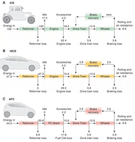

This paper in Science makes an interesting point on the comparative efficiencies of H2 - Fuel Cell Cars.
Hybrid Cars Now, Fuel Cell Cars Later
N. Demirdovenand and J. Deutch
13 August 2004, Vol 305.
http://www.sciencemag.org/cgi/content/abstract/sci;305/5686/974?maxtoshow=&HITS=10&hits=10&RESULTFORMAT=&fulltext=Hybrid+Cars+Now%2C+Fuel+Cell+Cars+Later&searchid=1&FIRSTINDEX=0&resourcetype=HWCIT"
Subscription:
http://www.sciencemag.org/cgi/reprint/sci;305/5686/974?maxtoshow=&HITS=10&hits=10&RESULTFORMAT=&fulltext=Hybrid+Cars+Now%2C+Fuel+Cell+Cars+Later&searchid=1&FIRSTINDEX=0&resourcetype=HWCIT.pdf"
It compares Well to Wheel efficiencies of theoretical cars w/ a traditional ICE, a hybrid ICE+electric motor parallel drive train, and an H2 - Fuel Cell+battery buffer. They find the pure ICE has is 11.3% (no surprise), the H2-FC is 25.5%, but that the Hybrid is only ~1% less at 23.9%.
Assumptions:
-H-FC model: hydrocarbon fuel storage w/ a reformer (80% eff), fuel cell 50% eff., batteries 84% eff. If H2 is made available somehow without energy cost, eff jumps to 39%.
-Hybrid. Gas engine. If a diesel is used eff jumps 31.9%
The attached figure shows the relative energy flows. HICE = Hybrid ICE, AFC = Fuel Cell
