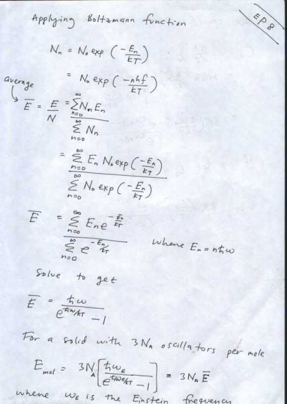

hello, i would like to as about the derivation of einstein model of specific heat.. this is the derivation that i copied from a book
http://i38.photobucket.com/albums/e122/asifadio/EP8.jpg
how the average energy equation(the summation on both numerator and denominator) can be solve to be like the one in the below of the picture?(below the statement 'solve to get')
using a geometric progression
