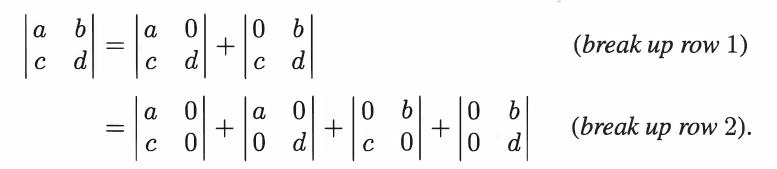

Here is an example of the decomposition for a 2 x 2 matrix
We have ##2^2=4## determinants, each with only #n=2# non-automatically-zero entries. By "non-automatically-zero" I just mean that they aren't zero by default. Of course, any of ##a,b,c##, or ##d## can be zero, but that depends on the matrix in question.
Now, two of the determinants above are automatically zero because they contain a zero column.
Turns out that for an n x n matrix, when we decompose the determinant like this, only #n!# of the determinants are potentially non-zero. All the others are automatically zero because of a zero row or column.

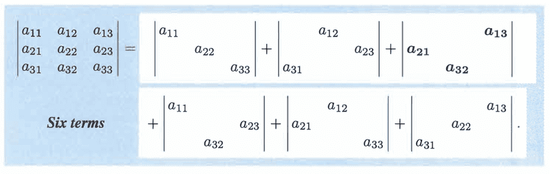

In (a) of the problem, Strang is considering the determinant of a 3 x 3 matrix. After decomposing it using linearity as above, we have 3! determinants which are potentially non-zero. Here they are for illustration
The characteristic common to these determinants is that the non-automatically-zero elements are each in a distinct row and column from the others.
We are essentially saying: we have n elements to place in n rows, and each element must be in a different column. There are n! ways to do this.
Notice that if any of the non-automatically-zero elements in a determinant are in fact zero, then that determinant becomes zero because a zero row and column are introduced. In the picture above, if any of the ##a_{ij}## is zero in any determinant then that determinant is zero.
Okay, so back to the question.
We can see from the picture above, that if ##a_{11}=a_{22}=a_{33}=0## then the non-bold determinants are automatically zero. Hence, the answer to (a) is 4.

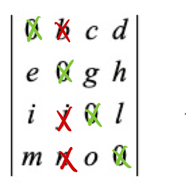

Consider the 4 x 4 determinant
We will have 4! = 24 of the non-automatically-zero determinants, but because the diagonal is all zero, some of these 24 will be zero for sure.
My strategy was to find the ones that are not zero for sure.
If we choose b in the first row as a non-zero element, then pictorially we have
and it seems we can now choose among three options on the second row. However, note that once we choose one on the second row, the third and fourth rows are locked in.
For example,
Thus, there are three possible non-automatically-zero determinants when choosing b on the first row.
The same argument applies when choosing c or d on the first row.
Thus we have 9 total non-automatically-zero determinants and so 24 - 9 = 15 that are zero for sure.
This is the answer to (b).
