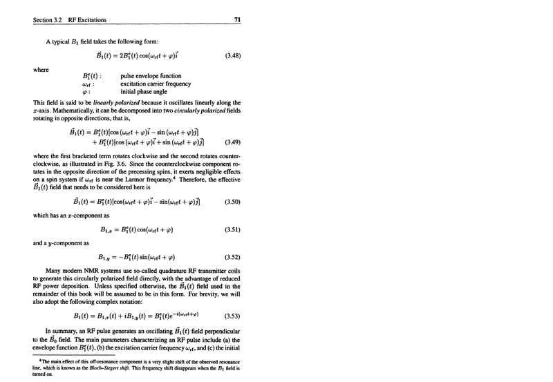

Hi, I am having trouble understanding how the B1 field as described by (3.48) in the image attached in MRI which is described as a linearly polarized field is decomposed into it's final two circularly polarized field as described by (3.49) in the image attached.
I understand that because it's 2B1 that you have one in the clockwise direction and one in the counterclockwise direction. That's why the first B1 has a negative in front of the sine term and the second doesn't. However, how do you get a cosine and sine term if in the first equation (3.48) if you only have a cosine to begin with. I know you describe a circle like the unit circle with cosine and sine but I still don't understand why a term with only cosine is expanded to cosine and sine. Clarification on how to go from 3.48 to 3.49 would be greatly appreciated.
You simply add and subtract the same term:
2a = 2a + b - b = (a+b) + (a-b)
This is a common trick used when you want to introduce an additional term, just like multiplying by ##b/b##.
Likes Jen2114
Thank you ! I wasn't aware of this but now that I am it makes much more sense!
