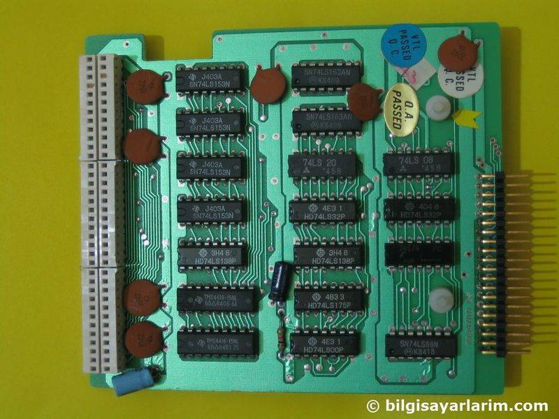

Since the OP's title uses the term "decoupling" capacitor, I thought seeing them decoupling noise from a pcb IC supply trace in a picture might be useful. Compliments of http://bilgisayarlarim.com/VTech/Laser_3000/
Thanks but I'm not at the point where I can look at that picture and see anything other than noise in terms of the inferable system logic.

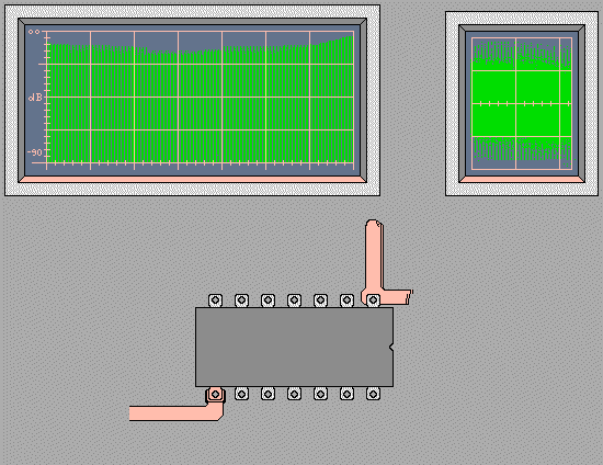

Actually it's fairly simple. The capacitors are across the integrated circuit's power supply "+" and "-" traces. See what happens to the noise? The closer to the chip the better they decouple (they're also know as bypass capacitors).
GIF file complements of http://www.williamson-labs.com/480_anim.htm
That's a nice animation. The little green chip at the very end is a miniature capacitor?
Yep. :)
also notice the extra circuit copper forming a "ground plane" which can also decouple.
