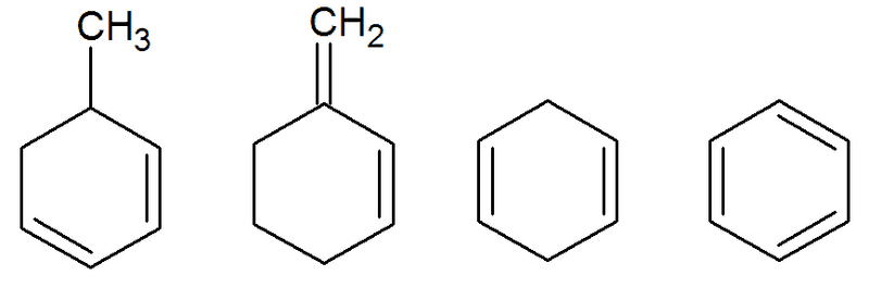

Decreasing Stability order of given I, II, III, IV (in order)
A)IV>I>II>III
B)I>IV>III>II
C)I>II>IV>III
D)IV>II>I>III (My Answer)
Since the IV is most stable, only A and D answers are worth checking. They only differ by stability order of I and II.

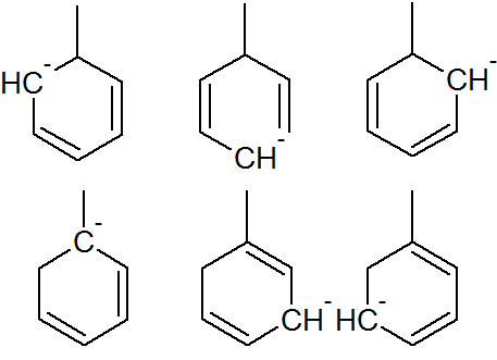

Then I checked by determining their stability due to hyperconjugation. I has HC3 while II has HC4, hence my answer D. But the correct answer is A. Any suggestions, whether my answer or provided answer is correct?
I think it's A). Exocyclic double bonds are less stable than internal double bonds for 6-member rings but exocyclic double bonds are more stable than internal double bonds for 5-member rings.

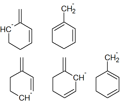

Still, as a last resort, I tried using my old habit of giving bluff explanation to support the answer (even if it isn't :-p) and drew out the structures possible in Hyperconjugation
For I
For II
Since I has 6 structure while II has 5 structures, I is more stable :biggrin: (I know I am talented :blushing:)
Brown's hypothesis simply states that exocyclic double bonds to six-member rings are more reactive than double bonds inside the ring and double bonds exocyclic to a five-member ring are more stable than those within the five-member ring. This is supported by reactivity data.
