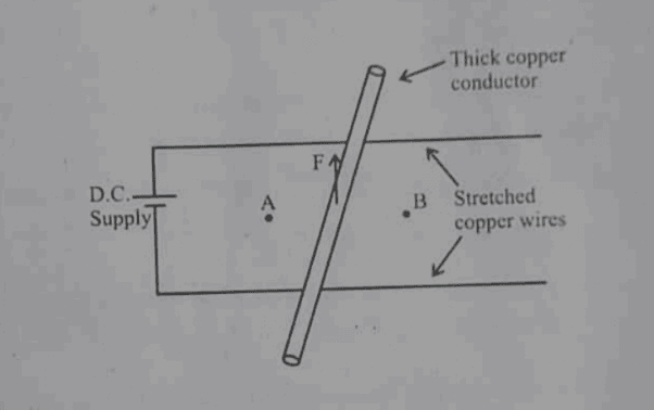

As shown in the diagram, a copper conductor is placed over two stretched copper wires whose ends are connected to a D.C. supply. What should be the magnetic poles at points A and B lying on either side of the conductor to experience the force in the upward direction?----------
My understanding was that I tried to use Flemming's left-hand rule to figure out the polarity at the points. I followed the common manoeuvre which is as follows: I placed my central finger along the flow of current through the conductor and my thumb along the indicated force vector. A bit of confusion arose from here that the finger was just pointing from A to B so I used some of my understanding and concluded since the finger points towards B it may be as though the field lines were entering from below B and coming out of B i.e. perpendicular to the plane of the paper on which this dia is drawn. Since we see field lines coming out of that point I concluded that that point is the North pole and A is south.
Another thing was since the current flowed in a clockwise loop made with the conductor thus the pole at A must be south hence at B automatically north pole.
So after these two considerations, I concluded that the poles at A and B are the south and the north poles respectively.----------

Ehm sorry I think I misunderstood the statement of the problem, do we want the force on the thick conductor to be upwards?
Umm, Yeah
Ok fine then indeed we have to use flemming left hand rule, but by doing so I concluded the A must be north and B south.
lol (I was just reading through your reply and was peacefully smiling until I saw some of your final words)
Could you please explain how? Why do our answers differ?
Using FLHR I concluded that the field must point from A to B, hence A must be North and B south
Likes Darshit Sharma
I agree with your conclusion.

In what direction is the current, top to bottom or bottom to top in the figure?
Given the direction of the current, you know that the magnetic field must be perpendicular to the plane defined by the force and the current. Furthermore, the direction of the force is given by the vector cross product ##\mathbf{F}=I\mathbf{L}\times\mathbf{B}## where ##\mathbf{L}## is the length of the rod in the direction of the current. You need to find the direction of the field ##\mathbf{B}## that will give a force in the given direction using whatever-named rule you have learned to find the direction of a cross product.
Darshit Sharma said:
Homework Statement: Magnetic poles at the points A and B lying on either side of the conductor to experience the force in the upward direction
Relevant Equations: Flemming's left hand rule and Right hand thumb rule
Here lies the core of your reasoning. It is completely correct when you say that the (first) finger (the pointer finger, not the thumb finger) is pointing from A to B, hence that is the desired direction of the magnetic field. It is well known fact that the magnetic field points from North to South. I can't follow the rest of your reasoning that says that magnetic field lines entering from below B and coming out of B. You do some sort of intuitive thinking in 3D space which i cant follow but thinking in 3D (regarding the magnetic field lines, of course we have to think in 3D regarding the FLHR) is not required here, once we know the direction of the magnetic field as an arrow pointing from A to B, that is all that we need.

It is not a well-phrased question. Here is my interpretation and my reasoning for it.
We have two rails connected to a power supply and a rod across the rails completing the circuit. A current runs through the rod and the rod experiences a Lorentz force perpendicular to the plane of the rails due to the presence of an external magnetic field. In most, if not all, problems with this kind of setup the magnetic field is uniform and we can assume it to be so here.
The question that, I think, is really asked is "What direction must this external magnetic field have so that the force is perpendicular to the rails as shown?" Thus, after we answer the real question, we have to figure out which pole of the magnet creating the external field should go to A and which to B.
Yes
Till now what I have understood and @Delta2 has made me understand is that the field is directed from A to B which implies that the pole at A should be a North monopole and at B a South monopole. This was well endorsed by you in #13. However, while approving all these things and clearing my doubts after @Delta2 said the following:
I simultaneously, to get a deeper insight into this topic, raised another question which was separate from the already-in-discussion question. The question was: If there was no force arrow given in the original question i.e. just a simple square loop of wire involving a conductor in its path was given then what would be the magnetic pole at point A?
@Delta2 was right when he said I was confusing both of these things.Moreover, while reading the conversation myself I discovered that I was not clear throughout and I am solemnly conscience-stricken.
Therefore, the new and final question is:
If I have a square loop of wire as shown in the figure below, what will be the direction of the magnetic field and thus, the polarity inside the loop when viewed from above that is as we are viewing the screen.
My try at this:
If I try to use the "Right hand thumb rule" and place my thumb along the current I2, I get a grip something like this which I have tried explaining:
My fingers curl inward from within the plane outside the loop (To the left of AB) then curl over AB and finally curl into the square loop. Now, as @kuruman explained to me in another post if I imagine a tangent at that point (which point? The point at which my curling fingers pierce through the plane, inside the square loop) the tangent obviously points below the plane ABCD now as I'm told by @Delta2 that if I have a field which is directed from above the plane then into it and then finally below it, I'll get a north monopole above the plane ABCD and a south monopole below the plane ABCD because the field lines must be going from the north to the south.
Thus, after solving the preliminary question, My first question is in which direction will the compass needle point if it is placed inside the loop? How could it point inside the plane (or paper whatever)?
Second, if I place the needle above the wire AB, the north is at the inside of the loop, right? then why does the needle point towards the left that is to the left of the wire whereas it should have done toward the right (i.e. towards the middle of the loop where the north is)?
