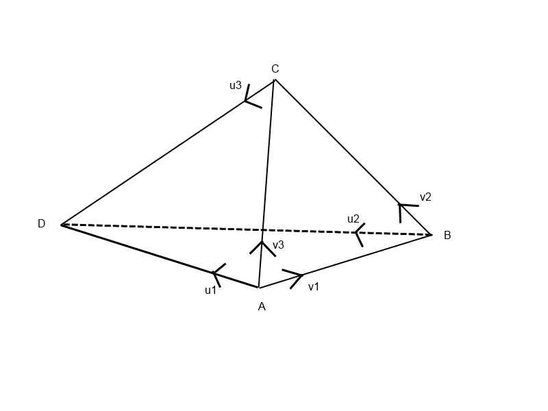

I have a unique problem that I'm struggling with with regards to surveying.
Because my surveying equipment is much more accurate at measuring angles than distances I'd like to find an analytic solution using only the angular measurements.
Let the surveyor sit at the origin of the coordinate system and represent the known vertex of the tetrahedron (or greater polygon if necessary.) I can then measure azimuth and pitch to each of the 3 (or up to 6) survey prisms allowing me to construct a unit vector pointing from the origin towards that prism (but magnitude remains unknown.) I also have precision CMM measurements of the relative geometry of the prisms, although not it the surveyors reference frame.
Thus, if A, B and C are the prisms I know the lengths of AB, BC, and AC along with the angles between them. Again, I also know the unit vectors that points from the Origin "D" to A, B and C, - Va, Vb, and Vc respectively.
I'd like to calculate the position (x, y, z) of points A, B, and C in the surveyor reference frame.
It's understood that the solution will not be unique in some cases but that surveyor location can be chosen to eliminate many multiple solutions. Also, the surveyors less accurate distance measurement can be used to select the proper solution if multiples exist.
Any help to a first time poster would be greatly appreciated.

Hopefully I've interpreted your problem correctly. If not, perhaps you can attach a picture showing the situation.
If we take the origin (your point D) to be the zero vector, and ##a##, ##b##, and ##c## are the vectors from the origin to the three prisms, you know the unit vectors ##a/\|a\|##, ##b/\|b\|## ,and ##c/\|c\|##. And you also know the vectors between each pair of prisms, namely ##a-b##, ##b-c##, and ##a-c##. Your goal is to find ##\|a\|##, ##\|b\|##, and ##\|c\|##.
Let's introduce some notation for the known unit vectors: ##u_a = a/\|a\|##, ##u_b = b/\|b\|##, and ##u_c = c/\|c\|##, and for the known difference vectors: ##v_1 = a - b##, ##v_2 = b - c##, and ##v_3 = a-c##. Then we have:

Sorry, I only have a vague mental picture of your setup. Is it not feasible to measure the angles between the u and v vectors? It seems like you could stand at each prism, and point one end of the measuring device toward one of the other prisms (that's the direction of the v vector), and point the other end at the observer's position (u vector)? I'm using the term "end" loosely - I'm not sure what sort of device you are using to measure the angles - but I assume you get the idea.
Anyway, please do post if you find a solution! It's an interesting problem.
P.S. Here's the picture I have in mind. I've plotted the four points and the directions of each of the u and v vectors. Some of the vectors may have opposite signs from what I wrote in the equations above, but that's just a small detail. Let me know if it's actually some other configuration.
Fundamentally your drawing is correct. To imagine the problem a bit more intuitively, the vectors u1, u2 and u3 should reverse their sign and originate at the origin ("D"... the laser total station.) But as you said, that has no real effect on the math.
