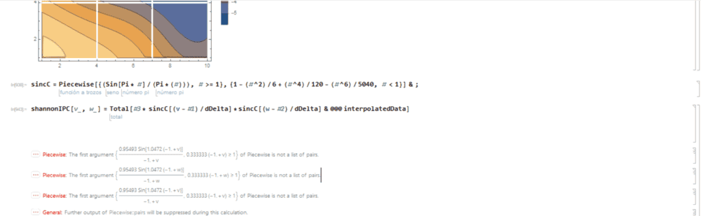

I am trying to do a 2D Shannon interpolation, but I cannot use a sinc because later on this expression goes in an optimization software that doesn't recognize it. I have defined my own version of sinc as:
sincC = Piecewise[{(Sin[Pi* #]/(Pi*(#))), # >= 1}, {1 - (#^2)/6 + (#^4)/120 - (#^6)/5040, # < 1}] & ;
The problem comes when I use the aforementioned sincC to construct the Shannon interpolation function.
shannonIPC[v_, w_] = Total[#3* sincC[(v - #1)/dDelta]*sincC[(w - #2)/dDelta] & @@@interpolatedData]
interpolatedData is a matrix of three columns and dDelta is a constant equal to 10. The error can be seen in the attached image, but it reads as
Piecewise:The first argument {(0.95493 Sin[1.0472 (-1.+v)])/(-1.+v),0.333333 (-1.+v)>=1} of Piecewise is not a list of pairs. and I am clueless about what to do.

You need an extra pair of {...} to enclose all of the pieces of your piecewise function
Likes confused_engineer
Thank you very much. That was it.
