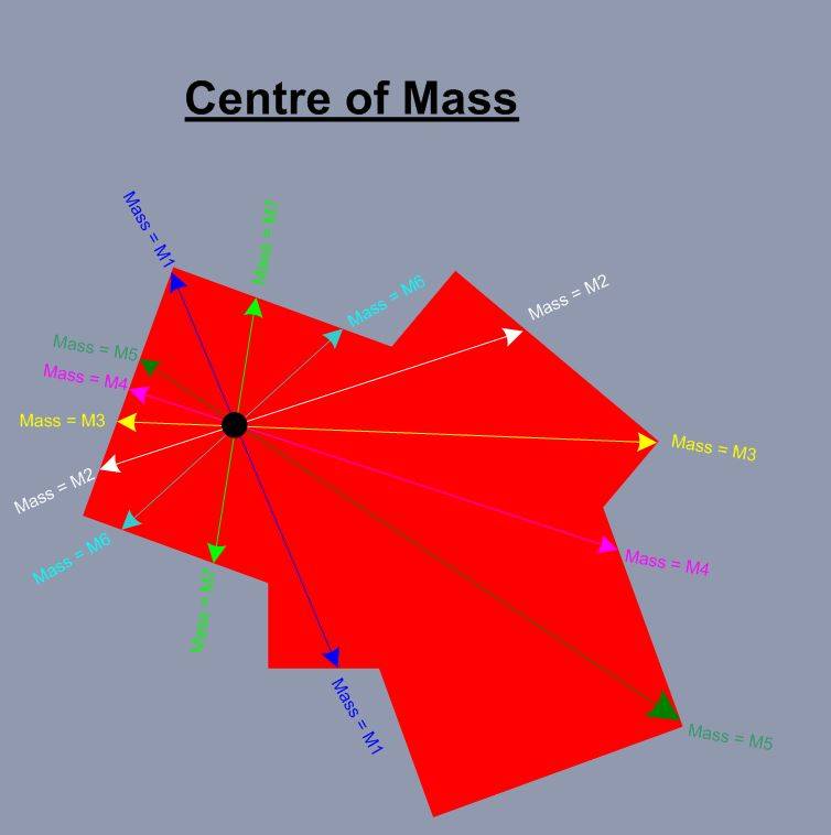

In all honesty these concepts are still bothering me, if I may ask;
I define Centroid as the centre of the shape or geometric centre. For me what that means is that if the shape theoretically weighed nothing i.e. had no density/mass then the shape would still have a centroid and that centroid would be the shapes centre.
I would define Centre of Mass as, "the point at which the distribution of mass is balanced in all directions (and this property is independent of any external gravitational field) (thank you collinsmark ). I have drawn a picture of what centre of Mass means to me:-
Here I have a red shape with the black point representing the centre of mass, this is the centre of mass because if I drew a line from one edge of the shape, passing through the black dot to the opposite edge of the shape, then the sum of the mass along the line from one edge of the shape to the black dot will be equal to the sum of the mass along the other end of the line from the block dot to the end of the shape.
I have tried to represent this with colored arrows where Mass M3 from the dot to the left side of the shape is equal to the opposite line from the black dot to the right edge of the shape.
Am I making sense?

I have drawn a picture of what I believe centre of mass is, I have posted this as a reply to Dr D - what are your thoughts on this?

These are what I said above in post #2. Centroid is independent of mass - it's a geometric average. Center of mass is an average taking into account mass distribution. Just like you said and showed...
Likes Dr.D and tomtomtom1
