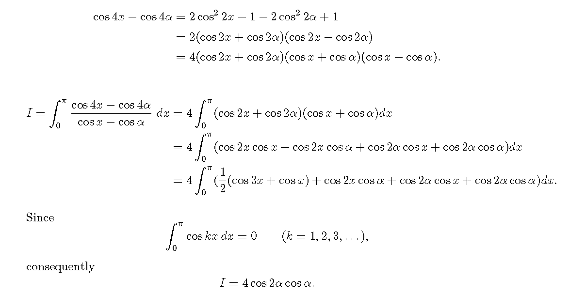

Evaluate the definite integral:\[I = \int_{0}^{\pi}\frac{\cos 4x - \cos 4\alpha }{\cos x - \cos \alpha }dx\]- for some $\alpha \in \mathbb{R}.$
[sp]It looks as though the answer should be $I = 4\pi\cos2\alpha\cos\alpha$ (because the constant is integrated over an interval of length $\pi$). (Cool)
[/sp]
[/sp]
Yes, indeed. A factor $\pi$ is missing in the answer. I am so sorry for this typo!
