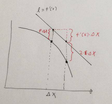

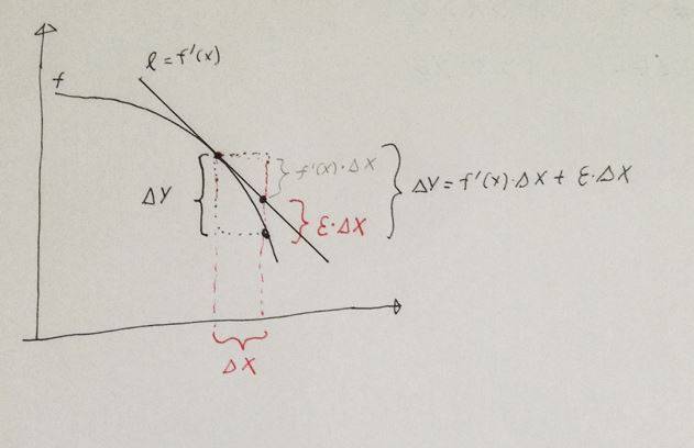

Thank you guys! Now I think i finally understand it 100% Clearly! - the infinitesimal approach to Calculus, so I'll try to explain it:
This equation
Δy =f'(x)*Δx +εΔx
means: an infinitesimal change in y ( an infinitly small distance in y-direction between 2 points ) of a function f can be found as a corresponding change in y of the slope of a tangent to the graph, hence the f'(x)*Δx, PLUS the the infinitemimal small distance between then graph and the tangent, hence then εΔx term.
So this Δy is the vertical y value between 2 infinitely close points on a graph of f.
and this f'(x)*Δx is the y-value between the same 2 points on the tangent to a point on f.
This εΔx tells us that the vertical y-value/distance between 2 points on the graph of f is + εΔx bigger than the vertical distance betwen the 2 points on the tangent to f which is f'(x)Δx
I added two figures to show that εΔx can either be the vertical displacement between the tangent and the graph of f , or the distance between the point (x+Δx, y+Δy) on the tangent and on the grap of f. However in reality εΔx would be MUCH smaller than f'(x)*Δx, but in the figure they look almost the same in size.
Fig 1 where εΔx is the vertical distance between the end point (x+Δx, y+Δy) of the graph of f and the tangent
Fig 2
where εΔx is the vertical distance between the tangent and the graph of f

I don't understand what you're doing in Figure 2. The line you show is not a tangent to the curve. A line that is tangent to a curve at some point touches the curve at that point.
Likes christian0710 and micromass
Ahh yes, i see your point: In the book is written "When f'(x) exists then The curve y=f(x) and the tangent line at (x,y) are so close to each other that they cannot be distinguished under an infinitesimal microscope." So i assumed that εΔx could also be interpreted as the distance between the tangent line and the function, but i see now that it makes no sense, so εΔx is to be interprete as figure one. Thank you for clarifying :)

Since i can't edit my older posts, I'm just going to make a last recap post to summarize everything with corrections amd better a better explanation. Calculus the infinitesimal approach - Thank you so much for the help!
This equation
Δy = f(x +Δx) - f(x)
Is the vertical distance between 2 points (x,y) and (x+Δx,y+Δy) on the graph of f. In our case they are infinitely close togther , so Δy, Δx, ε are infinitesimal.
Δy =f'(x)*Δx + εΔx
This expresses the same as the equation above: Vertical distance between 2 points of infinitesimal distance apart on a graph of f,
However this vertical distance is broken up in 2 parts f'(x)*Δx and εΔx which geometrically can be interpreted like this:
f'(x)*Δx is the the vertical distance between the 2 points (x,y) and (x+Δx , y+f'(x)*Δx) also called ((x+Δx,y+dy) on the tangent to the graph of f, touching f at (x,y)
εΔx is the vertical distance between the end point (x+Δx,y+dy) on the tangent and then end point (x+Δx,y+Δy) on the graph of f.
Δy =f'(x)*Δx + εΔx means: an infinitesimal change in y ( an infinitly small distance in y-direction between 2 points (x,y) and ( (x+Δx,y+Δy) on the graph of f ) of a function f can be found as a corresponding change in y on the tangent to the graph, hence the f'(x)*Δx, PLUS the the infinitemimal small distance between the graph and the tangent between the point (x+Δx,y+Δy) on the graph and ((x+Δx,y+dy) on the tangent, hence the εΔx term.
So if we look at the same equation, and we divide it by Δx,
(Δy =f'(x)*Δx +εΔx)/Δx
we get
Δy/Δx =f'(x) +ε
This equation shows us that the change in Y with respect to a change in X over a infinitesimal distance (between 2 points on f ) only comes near to f'(x), but the actual slope at ONE point f'(x) and the slope between 2 infinitesimal points Δy/Δx still separated by a small ε
Δy/Δx ≈ f'(x)
So for the equal signs to hold we need to add ε
Δy/Δx =f'(x) +ε
If we take the standard parts of this ratio, we get
st( Δy/Δx) = f'(x) =dy/dx=(f'(x)*dx)/dx = st(Δy = (f'(x)*Δx +εΔx)/Δx
standard parts means that if Δy/Δx is a hyperreal number ( hyperreal numbers includes real numbers + infinitesimals) - consisting of the sum of a real number f'(x) and an infinitsimal ε - then the difference between (f'(x) + ε) -(f'(x)) is infinitesimal, and so the standard part of f'(x) +ε, denoted st(f'(x)+ε) or st(Δy/Δx) is a real number f'(x) which is infinitesimally close to f'(x) +ε .
Δy/Δx = f'(x) +ε
st( Δy/Δx) = f'(x) =dy/dx=(f'(x)*dx)/dx = st('(x)*Δx +εΔx)/Δx)
This way of writing it should also be true
Δy/Δx =dy/dx +ε =f'(x) + ε
Δy = the change in y along a curve between 2 points ( a secant)
dy = is the vertical distance between two points on the tangent line and is equal by multiplying the horizontal distance dx with f′(x)
Δy/Δx Is the slope of a secant between 2 points of the function f.
dy/dx =f'(x) is the change in y with respect to x On the tangent line (So it's the slope of the tangent line) at the point (y,x). and i can be treated as a quotient or as a limit for f as dx aproaches zero.
dy =f'(x)dx So dy and dx are changes on the tangent line, this means the change in y, denoted dy, on the tangent is proportional to the change in x, denoted dx, f'(x) is the proportionality constant/slope at that point.
