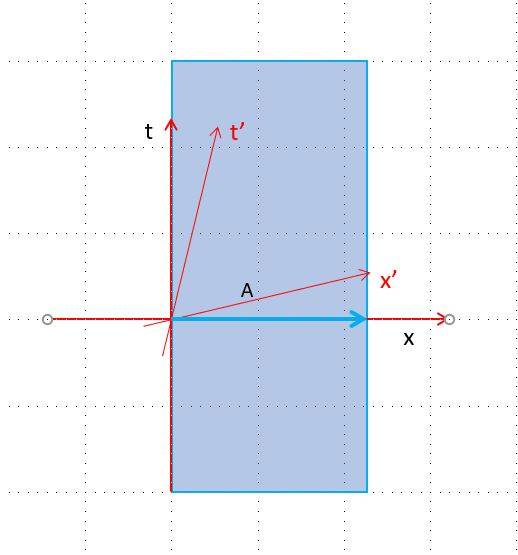

To explain how the gyroscope spatial axis is represented in spacetime.
The blue arrow represents the gyroscope axis in its rest inertial frame. Its worldsheet (light blue region) intersects the primed inertial frame's simultaneity plane (x' axis in the picture). So basically the primed frame describes the gyroscope axis as the projection of the blue arrow onto its simultaneity plane.

If I'm interpreting that correctly, then that is a spacetime diagram for two reference frames in uniform relative motion in the direction of a shared ##x-x'## axis?
Yes, the two reference frames moves along the same shared spatial direction.
Not quite. The blue arrow represents the 4-vector that describes the gyroscope's axis. The gyroscope has a definite state of motion in spacetime; it's 4-velocity is the vertical "t" arrow in your diagram. The 4-vector describing the gyroscope's axis is orthogonal to its 4-velocity and in the spacetime plane in which the axis points. This 4-vector is an invariant; it doesn't change when you change frames. It would only change if the gyroscope changed its state of motion (since the 4-vector describing the axis must remain orthogonal to the gyroscope's 4-velocity).
No. The primed frame might describe a component of the gyroscope axis this way. But, as above, the gyroscope axis itself is a 4-vector that is invariant; it doesn't change when you change frames. The key point in the primed frame is that the 4-vector of the gyroscope axis is not a purely spatial vector in this frame; it has a ##t'## component as well as an ##x'## component. Or, to put it another way, it is not orthogonal to the ##t'## basis vector.
I'm not sure I agree - or at least, it depends what one means by "axis". Certainly the blue and red arrows lie along what the two frames would call the axle. I'd have said that was a perfectly acceptable interpretation of "the gyroscope axis". Agreed that this isn't the same as the angular momentum axis, which is an invariant representable by the blue arrow, I think.
The meaning I am giving it is the standard one in relativity: that spacelike vector in the tetrad of which the gyroscope's 4-velocity is the timelike vector, that points along the gyroscope's axis. In other words, that particular spacelike vector in the 2-plane spanned by the 4-velocity and the "spatial ##x## direction" that is picked out by the invariant condition of being orthogonal to the 4-velocity.

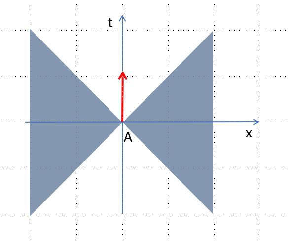

So the set of events representing the 'spatial ##x## direction' in the tangent space at event A is the blue area in the following diagram (region outside the light cone at event A). The red arrow represents the gyroscope 4-velocity at event A (the gyroscope has a given state of motion represented at each event along its worldline by the timelike tangent vector that lies in the tangent space at that point).
The inertial coordinates ##x,t## are chosen in such way that the gyroscope 4-velocity at event A is the ##t## axis and the ##x## axis is the spacelike vector orthogonal to the 4-velocity at event A (hence orthogonal to the ##t## axis).
  • #31
cianfa72 said:
the set of events representing the 'spatial direction' in the tangent space at event A is the blue area in the following diagram
The points in the diagram, since it's strictly speaking a diagram of the tangent space, represent vectors, not events; the vector represented by a given point is, heuristically, the arrow from the origin to that point, which gives a magnitude and a direction. The blue area thus represents the set of spacelike vectors in the plane of the diagram, i.e., the vectors that point in the "spatial ##x## direction".
Yes.
cianfa72 said:
The inertial coordinates are chosen in such way that the gyroscope 4-velocity at event A is the axis and the axis is the spacelike vector orthogonal to the 4-velocity at event A (hence orthogonal to the axis).
Yes.

  • #32
ok, so the gyroscope axis actually picks a 2-plane in the tangent space at each event along its worldline.
In a neighborhood of event A the set of spacelike vectors in that 2-plane (arrows from event A) let me say pick events spacelike separated from the event A in 'spatial ##x## direction'.
  • #33
No.
The actual gyroscope axis is represented by the blue arrow: the spacelike vector in the 2-plane that is orthogonal to the gyroscope's 4-velocity.
The other spacelike vectors in the 2-plane represent other possible gyroscope axes pointing in the "spatial ##x## direction", for gyroscopes whose 4-velocities are different at the event whose tangent space the diagram represents. The fact that they all lie in the same 2-plane in the tangent space, the ##x##, ##t## 2-plane, is what justifies us saying that all of those different gyroscopes, with different 4-velocities, all have axes that point in the "spatial ##x## direction".
  • #34
So let me say the arrows in blue region in my diagram actually represent in spacetime the 'class of equivalence of gyroscopes having axes pointing in the same 'spatial ##x## direction' at event A'.
  • #35
Strictly speaking, the arrows in the blue region represent the class of axes of such gyroscopes. The gyroscopes themselves have a 4-velocity as well as an axis so the axis itself does not completely represent the gyroscope.
However, since the axis and the 4-velocity are orthogonal and the 4-velocity is timelike, if you know the 4-vector representing the axis, you also know the 4-vector representing the 4-velocity. So in that sense, yes, the arrows in the blue region are sufficient to represent this class of gyroscopes.

ok so, technically, we get the set of 'events spacelike separated from event A in spatial ##x## direction in a neighborhood of A' by means of the exponential map of those spacelike vectors lying in that 2-plane (the 2-plane that each gyroscope's spatial axis in the class pointing in ##x## spatial direction picks/selects in the 4D tangent space at event A).
  • #37
Yes.
