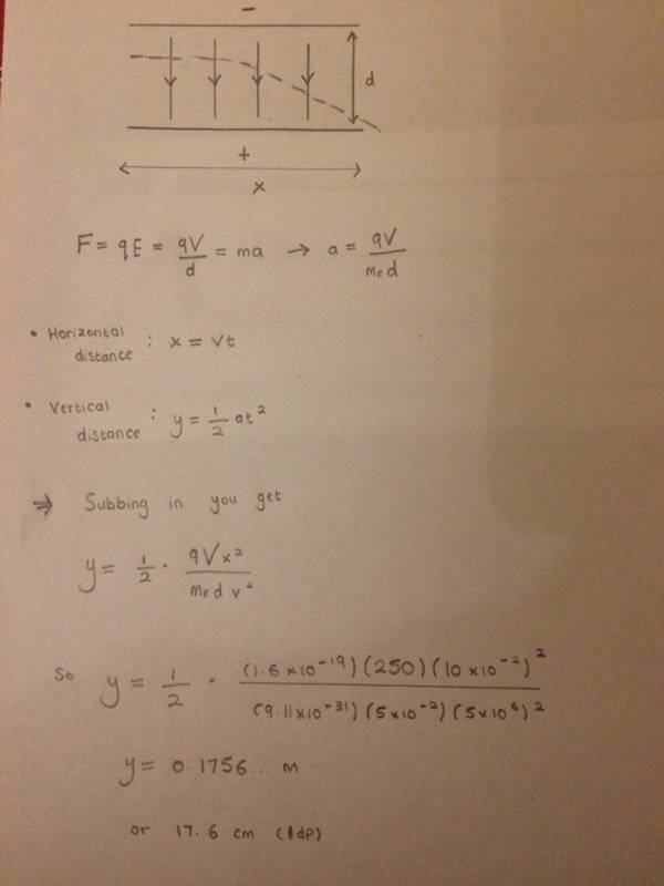

This is what I have done but get a value that doesn't match to any of the options given above?
Any help would be really appreciated, Thanks!
I agree with your answer of 17.6 cm. Your work looks very good. But in your diagram, if the electric field is downward, would the electron be deflected downward?
Sorry my field line directions should be reversed (going from positive to negative)
So the question must have a mistake then I guess. I believe the first option would’ve been the right answer but maybe the person who wrote this misplaced the decimal point position and instead got 1.76cm and not 17.6cm :oldconfused:
Yup. Given the question-given values the beam will impact the positive plate about halfway through the parallel plate channel. So original problem statement FAIL. This happens frustratingly frequently, especially when older problem sets are "updated" to change the working values to "refresh" the problem for new editions of texts or exams.
