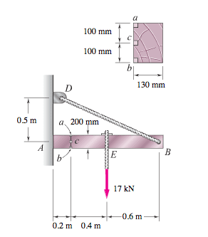

Can you use a supporting cable to help?
http://media.cheggcdn.com/media/339/339bef0e-5707-4c7e-b0d1-eb9d4b8afef9/phpB1vxDf.png
Optimised variable section .
Rigid stay .
Haunch .
Cable stay shown is not set at a very effective angle to reduce deflection .
Cable stays with no provision for setting tension are in any case not a reliable means of reducing cantilever beam deflection .
