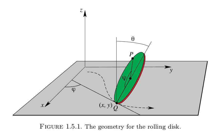

I thought that a bike could be simply modeled as two wheels attached by a rigid bar. If the wheels move without sliding, then there is one degree of freedom: one of the wheels moves and so does the other one since they are rigidly attached by the bar. Then, if the wheels can turn to the right or the left, then there are two more degrees: one angle for each wheel.
Is it ok?
in general case the rolling disk (without slipping) has three degrees of freedom
just for information
Likes Like Tony Stark and etotheipi
Like Tony Stark said:
Homework Statement:: Design a very simple model for a bike and state the number of degrees of freedom
Relevant Equations:: Generalized coordinates
It would be unusual for the rear wheel to be able to turn away from the line of the bicycle.
So should I consider just one degree of freedom?
As @wrobel points put, you also need to consider the angle the bicycle makes to the vertical.
