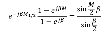

I have to simplify this beam form (equation 1) which simplifies to equation 2 and then finally to equation 3.
equation 1: e^-ix((1-e^y)/(1-e^z)) where x = Beta*M_(1/2), y = beta*M, z= Beta
equation 2: sin(M*Beta/2)/(sin(Beta/2))
equation 3: M((sinc(M*Beta/2pi))/(sinc(Beta/2pi))) where sinc(x) = sin(pi*x)/pi*x
Eulors: e^jx = cos(x) +j*sin(x)
I have tries to use eulors equation to change it to sine sand cosine but I can't seem to get the proper cancellations i am looking for.
What is M_(1/2)?
Do you mean ##e^{-i\frac{\beta}2(M-1)}\frac{1-e^{i\beta M}}{1-e^{i\beta}}##?
Sorry about the late response. It is M1/2 as a subscript, I attached a picture. I am going to the math department for some guidance since I can't seem to figure this one out. Any help would be appreciated,
So what is the relationship between that and M? To get your eqn 2 I need it to equal (M-1)/2.
To get it in this form we had to assume M = 2*M1/2+1. so . There were some other step to get it into the equation form but this is where it originated from.
Are you saying to get eqn 1 you already assumed that?
I assume you know how to write sin x in terms of eix.
Can you see how to write 1-e-ix as some function f(x) multiplied by a sine function (not necessarily sin(x), exactly).
