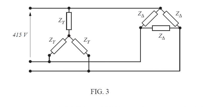

For the balanced three-phase loads shown in FIGURE 3,
ZY = (15 + j15) Ω and ZΔ = (45 + j45) Ω. Determine:
(a) the equivalent single Δ-connected load,
(b) the equivalent single Y-connected load obtained from the Δ-Y transformation of (a) above,
(c) the equivalent single Y-connected load obtained by transforming the Δ sub-load of FIGURE 3 to a Y and with the star-points of the two Y-sub-circuits connected together,
(d) the total power consumed in case (a) above if the line voltage of the three-phase supply is 415 V at 50 Hz.

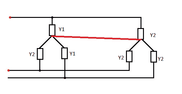

(c) Is the diagram C2.png how the transformation and two Y sub-circuit connected star points should look like?
I need a hint on how to form the equations for this if it is correct(im sure its obvious but I am not sure.)

For (a) they want a single Delta load. You've converted the Y to a Delta but now you have two Deltas as loads. Combine them into one.
For (b) they want you to take the single Delta from above and make a single Y.
Your diagram for part (c) doesn't make sense. You should have the single Delta that results from part (a) connected appropriately to the source. Having the line voltage and a Delta connection should make finding the power fairly straightforward... note how the individual impedances of the loads are connected to the sources.

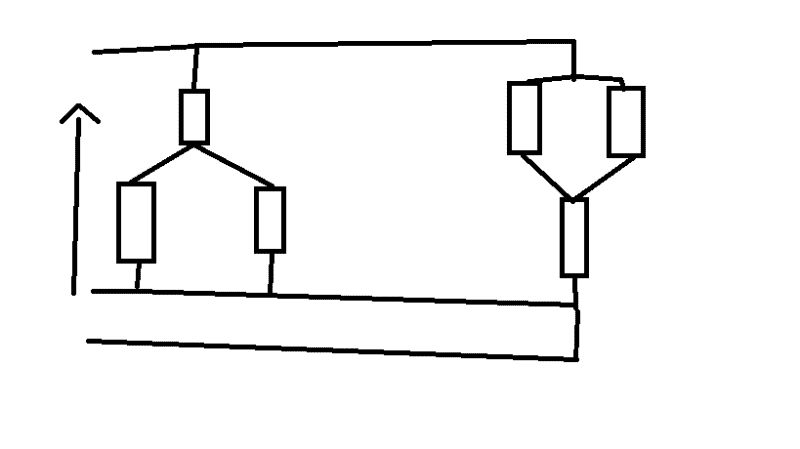

For part C would the circuit look like this (see picture) before I make it into 1 single Y load.

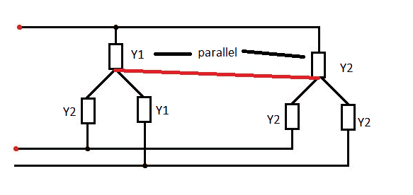

Part C also specifies: "...and with the star-points of the two Y-sub-circuits connected together," What do you suppose is meant by that?
  • #34

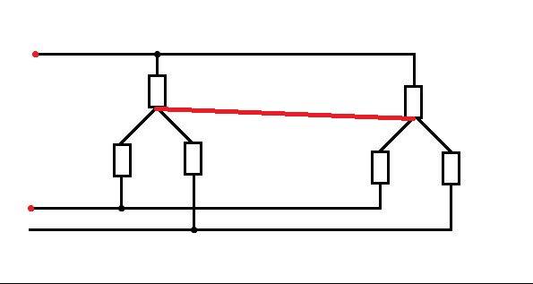

Would it be like this?
  • #35
That would be my interpretation, yes.
