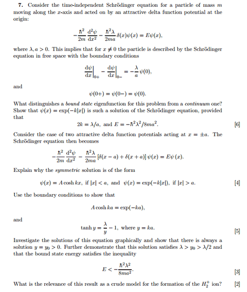

Consider the TISE for a particle of mass m moving along the x-axis and interacting an attractive delta function potential at origin:
Part(a): What is the difference between a bound state particle and a free particle?
Part(b): Show ##\psi _{(x)} = exp (-|k|x)## is a solution of TISE, given conditions:
Part(c): Explain why symmetric solution is of form:
Part(d): Use boundary conditions to show the following:
Part(e): Investigate this solution graphically
Part(f): Find the significance of this result

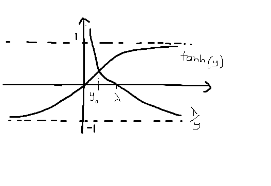

Part (e)
We can see that ##y_0 < \lambda##.
Since ##tanh(y_0) < 1##, thus ##y_0 > \frac{\lambda}{2}##.
Since for x≠a both delta functions are positive, it implies that the second term corresponding to the two delta functions ##\delta_{(x-a)}## and ##\delta_{(x+a)}## in the schrodinger equation are >0. Thus the total energy subtract that is less than ##-\frac{\hbar ^2\lambda^2}{8ma^2}##.

Part (e)

But graphically you can see that it is symmetric about 0. You can also see that at x-ε the gradient is opposite that of at x+ε.
It may look that way in the picture when you have a single delta function, but this time you have two. You no longer have the symmetry you had before. You need to justify the boundary condition mathematically.
