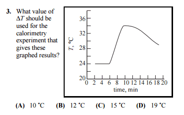

See Thumbnail.
N/A
I am absolutely floored as how to do this problem.
What was the initial temperature? What was the final temperature?
The initial temperature is 24 degrees Celsius and the final temperature is 29 degrees Celsius. However, 5 degrees Celsius as a delta T is not an option given :/
Ah, I see where your problems steams from.
Final temperature is not the one measured after the system had time to cool down (actually if you wait long enough final temperature will be the same as the starting one). Final temperature is the one observed after the reaction ended (so it is the maximum temperature observed).
Sometimes things are slightly more complicated, as the systems cools down even before it completely heats up, then, to get the maximum temperature, you may have to extrapolate. But it doesn't look like it is the case here.
Yes, this is exactly the explanation I found elsewhere! Thank you so much, Borek!
