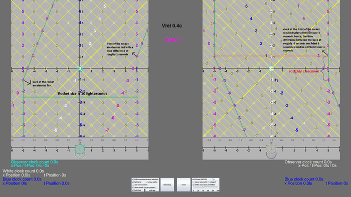

Following scenario:
A rocket measuring 10 lightseconds in length accelerates near instantaneously to v=0.4c. Pre-acceleration two clocks placed at the endpoints of the rocket were synced.
What will be the time difference between the two clocks post acceleration?
I tried to figure it out, using two x-t diagrams, drawing the worldlines of the rocket's endpoints (green lines) as i would imagine them.
Considering the innacuracy of the drawing, my rough estimate is that the time difference will be slightly over 4 seconds. Did i get it right?
Here are the x-t diagrams
edit: Also, is the time difference between the two clocks post acceleration decided only by the final velocity or does the "type" of acceleration (faster/slower) matter?

The spacetime diagrams show "exactly" when the back of the rocket and the front of the rocket accelerate. Assuming the clocks at the back and end of the rocket were in sync pre-acceleration, the back of the rocket would accelerate when the clock displays t = -1s roughly. The front of the rocket would accelerate at t = 1s roughly.
The rocket clocks would be in sync with the violet clocks pre-acceleration. The rocket is in the rest-frame of the violet clocks pre-acceleration.
The rocket keeps its size in whichever rest-frame it is temporarily even during the acceleration. It certainly has the same size post acceleration in its rest frame.
The cyan colored clocks on the right x-t diagram are 10 lightseconds apart from each other. Exactly the size of the rocket. The worldlines of the rocket will eventually overlap with the cyan colored clocks' worldlines according to logic (my logic maybe).
I do believe that my drawings accurately reflect the scenario, but prove me wrong. Someone certainly would know how to calculate the exact time difference between two such clocks.
And while i am not certain at the moment, i do believe that the time difference is independent on if you would accelerate instantaneously or choose a less brutal acceleration to reach 0.4c.

For what it's worth, I agree your analysis of the time difference in the right frame of two clocks initially synchronised in the left frame and following the worldlines you have drawn. However, this doesn't represent a plausible physical model of a 10 light second long rocket, since the front of the rocket accelerating is not causally connected to the back of the rocket accelerating - the events are space-like separated. Edit: Unless you've got rocket motors all along the length of your rocket, and they're set to fire synchronously in some frame, or something of that sort.
Given your two diagrams, it's easy to see this. In your first diagram, the rocket's front end accelerates two seconds after the back end. In your second diagram, the rocket's front end accelerates two seconds before the back end. The total time difference will be the sum of these two differences.

According to the x-t diagrams, the difference in times should be slightly over 4 seconds. Not exactly 4 seconds. I expect a value between 4 and 4.1, less than the 4.36s value Slowthinker got. In theory i could calculate the exact value by getting the exact times/places for when the worldlines of the cyan and violet colored clocks cross but that would require me to figure out the math.
edit: It is the second question which i find more interesting to answer once we have an agreement on the time difference. Does the type of acceleration matter for the time difference we get, or is it decided only by the final velocity?
I think the latter is the case but i could not fully wrap my mind around it yet.
I make it 4.17s (actually ##10(5-\sqrt {21})##s). The reasoning is this:
In the original rest frame let the back of the rocket start accelerating at the origin of coordinates. The front of the rocket follows ##x=L## before accelerating and ##x=vt+L/\gamma## afterwards. The front-of-rocket acceleration event is where these two lines meet, which is ##x=L## and ##t=(L/v)(1-1/\gamma)##. In the post-acceleration frame, this is ##x'=L## and ##t'=-(L/v)(1-1/\gamma)##.
For the back of the rocket the elapsed time between ##t=0## and ##t'=0## is zero. For the front of the rocket, though, it's the time from ##t=0## to the acceleration event at ##t=(L/v)(1-1/\gamma)## plus the time from the acceleration event at ##t'=-(L/v)(1-1/\gamma)## to ##t'=0##. That is, the extra elapsed time is ##2(L/v)(1-1/\gamma)##.
Edit: That is, the times Jeronimus marked as "about 2s" in the left and right diagrams in the OP are actually both ##(L/v)(1-1/\gamma)## of proper time.
Put in the L=10 and v=0.4 and out drops my number.

4.17s seems too high still, going by the observation of the x-t diagram which are computer generated.
I don't think you can use the same formulas you use to determine the length of a rocket post-acceleration for this scenario. L/γ is not the case during the acceleration phase. But as always, i could be wrong.
All I'm doing is writing down the equations of the lines you drew. If the back of the rocket accelerates at time t=0 then it must follow x=vt. If the rocket is to have length L in its final rest frame then the front of the rocket must (eventually) be (a) traveling at the same speed as the back and (b) be ##L/\gamma## infront of it. That makes the equation of the line ##x=vt+L/\gamma##.
During the acceleration phase the length does vary, yes. But that's because sometimes there's a sloped worldline at one end simultaneous with a vertical one at the other. Doesn't change the equation of the lines.
Try it with v=0.8. My formula says the total time difference there is exactly 10s, 5 on each graph.
Edit: I find your graphs very difficult to read since there's so much going on in them, with the light cones and the numbers and the worldlines. In this case, you really just want regular graph paper and the worldlines drawn with the thinnest line setting you can have.
Well, let me try a different approach.
The Lorentz Transformation formula solving for x' is
x' = γ (x - vt)
The known for the acceleration event at the back of the rocket are:
x = -5 , x' = -5 , v = 0.4c , γ = 1.091... unknow t=?
solving for t we get
t = (x - x'/γ) /v = -1.04356...s t2 = 1.04356...s (the front of the rocket acceleration event)
now that we have t, we can solve for t' using the Lorentz transformation formula solving for t'
t' = γ(t - vx/c2) = 1.04356...s and t2' = - 1.04356...s (x2'=5 t2'=-1.04356...s is the spacetime position of the acceleration even in the right diagram - the violet clock counter displays _positive_ 1.04356...s however at this spacetime position)
deltaT = t1 - t2 ~ 2.08712s
adding the clock counter of the violet clock at the front side, we get
2.08712s + 1.04356...s = 3.13...s
so we have two events which are simultaneous in the right diagram and are on the endpoint worldlines of the rocket
x'=-5ls, t' = 1.04356...s - the clock count of the violet clock at the back of the rocket is showing -1.04356...s
x2' = 5ls, t2' = 1.04356...s - the clock count of the violet clock at the front of the rocket is showing 3.13...s here
edit: I made a little mistake there. The violet clocks are not the clocks placed inside the rocket. They are only in sync with the rocket clocks at the front at end pre-acceleration. Post acceleration, the violet clocks go out of sync(and move away from the clocks placed at the endpoints of the rocket) relative to the clocks placed inside the rocket. The clock counts at 1.04356...s and 3.13...s for the clocks inside the rocket are accurate though, except those are not the violet clocks. their clock counts therefore differ by 4.1742...s
Looks like you were right after all :D

PeroK said:
I make it that as long as ##\frac{\gamma Lv}{c^2}## is small, the the formula is a good approximation.
But in this case that quantity ##20/\sqrt{21}##, which is slightly larger than 4 which is not small in this context. That's why jartsa gets a different answer to Jeronimus and me.
I've changed my mind. I think that formula in post #20 is correct. We don't have to worry about coordinate time. We can just work within the accelerated coordinate system.
I've edited it.
As an addendum to post #20. You can calculate the difference in the clocks in the IRF in two ways:
1) From post 20, we have that the front clock is ##\frac{L}{c} tanh^{-1}(\frac{v}{c})## ahead in the ship's frame, after the acceleration, when the ship is moving with constant speed ##v##. In the original IRF we would have the normal ##-\frac{Lv}{c^2}## difference in the two clocks, so in the original IRF we would have that the front clock is ahead by:
##\frac{L}{c} tanh^{-1}(\frac{v}{c}) -\frac{Lv}{c^2}##
2) To calculate this solely in the original IRF we have:
##t_0 = \frac{\gamma v}{a}## is the time the rear of the ship stops accelerating and its clock reads ##\tau_0##
##t_L = \frac{\gamma v}{a} + \frac{\gamma vL}{c^2}## is the time the front of the ship stops accelerating and its clock reads ##(1 + \frac{aL}{c^2}) \tau_0##
In the time difference ##t_L - t_0## the rear clock advances by the time-dilated ##\frac{vL}{c^2}##. And, with ##\tau_0 = \frac{c}{a} tanh^{-1}(\frac{v}{c})## we have the difference in the clock readings of:
##(1 + \frac{aL}{c^2}) \tau_0 -\tau_0 - \frac{vL}{c^2} = \frac{L}{c} tanh^{-1}(\frac{v}{c}) -\frac{Lv}{c^2}##
Note that I used this method to get the correct length contraction of the ship at the end of the acceleration, so it feels quite sound to me now.
Likes Jeronimus
http://cyberleninka.ru/article/n/o-...ostkogo-sterzhnya-2-rassinhronizatsiya-chasov
Formula (29)
I am getting
10s * tanh-1(0.4) - 0.4s = 0.2364893...s with my calculator.edit: Never mind. I see now. You calculated the difference in clock counts for the original/initial IFR, not the IFR the rocket is at rest in post acceleration.
