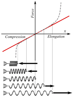

I understand the question as the OP stating linear mass density, that should be in units of mass/length (kg/m), and not mass/volume.
Suppose you take a steel spring of given length and number of coils/unit length.
The linear mass density of the spring is the number of coils per unit length.
Now if you stretch the spring then the number of coils per Δχ is not the same everywhere in the spring. (There are more coils per unit length at the wall than at the other end which means the linear density drops)
In other words the spring appears more stretched at the other end than at the end attached to the wall.
I have included a picture which shows that a stretched spring has the same number of coils per length everywhere (maybe this is idealized but still has to be explained theoretically) but this is NOT what you see if you do the experiment at home with a normal spring.
It's fairly easy to calculate the number of coils per unit length at each point along the spring's length as a function of the spring's stiffness at each point. If the spring has the same stiffness all along its length, the coils will be evenly spaced. If it doesn't, they won't be.
I conclude that your spring is not uniform along its length.
Flip your spring around and do the experiment again. Is the spring density now higher away from the wall?
The spring density is again bigger at the wall even if i flip it around.
The spring has the same density when it is not stretched and it doesn't matter which side i stick to the wall..

A real spring is well modeled by a series of small ideal massless spring-elements connecting idealized small mass-elements. A FBD is drawn for each mass etc.
A horizontal real spring is (usually) supported by a surface which will add drag when the spring is extended slightly. This can produce a varied coil density with horizontal distance. Perhaps in the home experiment
mkarydas had the spring lying on the ground or a table-top?
If it is supported only at the ends, then the spring will form a catenary - will will also show a changing coil density with horizontal length.
If the spring is suspended vertically, then the total mass below the higher spring elements is greater - resulting in a greater extension the farther up you go. (I'm looking for an unambiguous picture of this online btw.)
But if we define mass-per-unit-length in terms of the path around the coils, that is a different story.
It seems that this was not what OP intended by linear mass density. <phew>.
Breaking the spring into small elements should be able to deal with the case that there are no drag or weight forces acting on it - but this is not a situation you can easily test at home.
