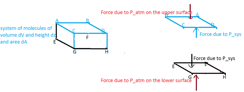

What I have understood:
Using the symbols already defined in the above posts ( particularly ##\rho## for mass density and M.W. for molecular weight),
Let's consider a small volume dV of air molecules at height h as our system.
Let's consider the equilibrium of the massless surface enclosing this molecules.
Now, according to Newton's first law, it is clear that
on any surface,
Force due to the pressure due to the molecules outside the system = - Force due to the pressure due to molecules inside the system
Pressure due to the molecules outside the system = pressure due to the molecules inside the system
Pressure due to the molecules inside the system of volume ΔV on any surface,
##P_{sys}= \frac n {ΔV } RT = \frac {\frac {Δm} {M.W.}} {ΔV} RT = \frac {\frac{Δ m }{ΔV}}{M.W.} RT##
In the limit ΔV→0
i.e. ΔV = dV, ## \lim_{ΔV→0} \frac{Δ m }{ΔV} = \frac{d m }{dV} = \rho##
##P_{sys}= \frac {\rho }{M.W.} RT##
##P_{sys} = P_{atm} = \frac {\rho }{M.W.} RT##....................(1)
Now considering the equilibrium of the system,
##P_{atm}(~on ~the ~lower ~surface) - P_{atm}(~on ~the ~upper ~surface) = \rho g Δz##
In the limit that Δz →0,
##\frac{dP_{atm}}{dz} = -\rho g
##.....................(2)
Solving the above two eqns.(1) and (2) along with initial conditions gives the required answer .
Is this correct so far?
