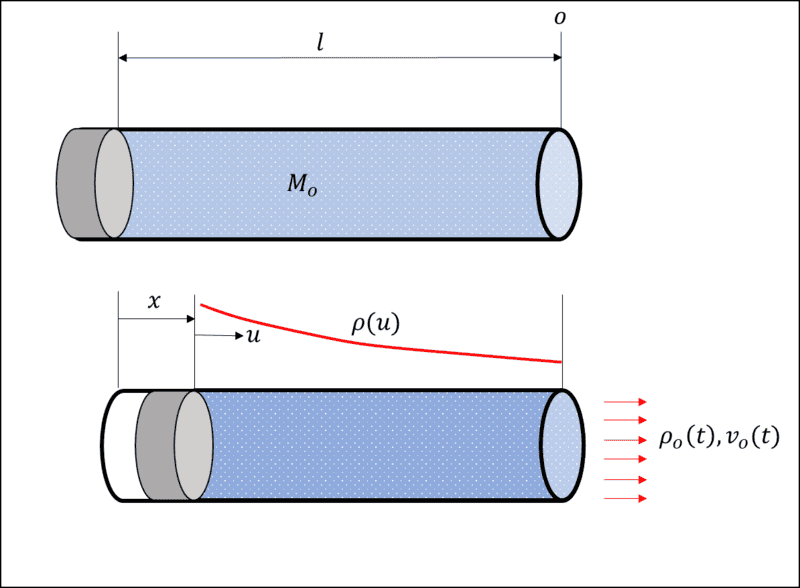

Determine the density distribution ##\rho (u)## along the tube as the piston advances
Conservation of Mass
I'm trying to figure out how describe the mass of air between the piston face and the und of the tube ( position ##o##) in the acompanying diagram.
At ##t = 0##, the mass of air in the tube is ##M_o##, and the system is static with tube length ##l##. The ##x## coordinate describes how far along the tube the piston has advanced at time ##t##. The ##u## coordinate ranges from the piston face to the end of the tube ## 0 \leq u \leq l-x ##
Let the density, and velocity (both assumed to be uniformly distributed over the cross section) of the outflow be given by ##\rho_o (t), v_o(t)##respectively.
Applying conservation of mass I get the following relationship:
$$ A \int_0^{ l-x(t) } \rho (u) ~du = M_o - A \int_0^t \rho_o (t) v_o (t) ~dt$$
Where ##A## is the cross sectional area of the tube, and the ##x## coordinate is given by:
$$x(t) = \int_0^t \dot x ~dt $$
My goal is to get ##\rho (u)## as a function of all the other variables. My instinct is to try transform ##du \to k ~dt ## and then differentiate both sides w.r.t. ##t##.
? Is it ok to write:
$$ \begin{aligned} u &= l-x \\ & = l - \int_0^t \dot x ~dt \\ \implies & \frac{du}{dt} = -\dot x \end{aligned} $$
Substituting for ##du## :
$$ -A \int_0^{ l-x(t) } \rho (u) ~\dot x ~dt = M_o - A \int_0^t \rho_o (t) v_o (t) ~dt$$
Now differentiate both sides w.r.t time ##t##:
$$ -A \frac{d}{dt} \left( \int_0^{ l-x(t) } \rho (u) ~\dot x ~dt \right) = \cancel {\frac{d}{dt} M_o}^0 - A \frac{d}{dt} \left( \int_0^t \rho_o (t) v_o (t) ~dt \right) $$
$$ \boxed{ \implies \rho(u) \dot x = \rho_o(t) v_o(t) } $$
Possibly I've performed some unsavory mathematics?
Suppose the piston were moving very slowly. Do you think the density would be changing with x or t?
If the piston were moving with constant velocity I expect that the velocity ##v_o(t) = \dot x## and the density to be uniform over ##u##. So ##\rho(u) = \rho_o(t) = \text{const.} ## ( in the absence of viscous friction ), But this is just about conservation of mass. Forces are irrelevant at this point as far as I can tell.

Conservation of mass requires that $$\frac{\partial \rho}{\partial t}+\nabla \centerdot(\rho \bf{v})=0$$. If the fluid is viscous, pressure will be a function of x, as will be density (via the ideal gas law). Velocity will also be a function of x and r. Startup (transient) adds time t, so P = P(x,t), ##\rho=\rho(x,t)##, and ##v=v(x,r,t)##.
I'm making the simplifying assumption that the properties are uniformly distributed over the cross-section. So, I'm neglecting the dependency on ##r##.
to that point, is what I did not cohesive with what you suggest? If not, where do I go off, because I can't see what else it could be.
If we include the viscous behavior of the air then the axial velocity must be a function of r because of the no-slip (zero wall velocity) boundary condition.
If air compressibility is included (as it must be), and the piston is suddenly set into motion at constant velocity, a compression wave will travel down the tube at the speed of sound. Upstream of the leading edge of the compression wave, the velocity of the air will be on the order of the piston velocity and the density will be elevated above the initial density. Downstream of the compression wave, both the density and the air velocity will be unchanged. So, until the compression wave reaches the tube exit, the exit velocity will be zero.

I provided my best judgment based on >50 years of fluid dynamics (my thesis area) experience. I stand by what I said.
Likes SammyS
I didn’t mean to imply you weren’t speaking from experience, (I’m not attacking your credentials, I have none)it’s just that I’m looking for a zeroth order model.
However, at 1 meter the transient shockwave is propagated in less than 0.003 s, so I don’t see what the argument is on that point.
My main concern is whether or not I could do what I did with the mathematics. I don’t feel that has been straightly answered yet. Perhaps I should repost in the math forum?
