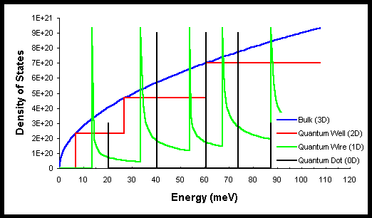

Hi there, I'm a bit confused as to the meaning of the following figure, for the quantum well case:
I understand that with the quantum dot, since the states are completely quantised you get the delta functions - states only exist at certain energies so the DOS at these energies is non zero (and zero at all other energies).
The quantum well case confuses me though. I understand that the energy levels within a quantum well to be quantised in one dimension. However, if the energy levels are quantised, why is the DOS not zero between these energy levels? In other words, why are there flat 'steps' rather than a delta function?
I can follow the maths behind the derivation of the DOS for a quantum well or dot, but without really grasping the physical meaning of what it tells us for the QW. Any help would be appreciated!

Hi Cthugha, thanks for your reply.
I'm able to follow the procedure you mention in terms of deriving the expressions that give the graphs shown in my first post. What I'm not clear on is a mental picture of what physically is happening.
I can understand the 1D quantum dots. Only quantised energy levels are allowed, so you get this series of delta functions occurring at the allowed energy levels. This I can understand easily.
The quantum well has quantised energy levels too, but in only one direction. Obviously, the reason we see the 'steps' and not the delta function spikes is in some way due to the fact that the electrons are not confined in the other two directions...but I'm not really sure why. I can follow the derivation of why, without really understanding properly what it actually means :/
I can see that when you increase the energy of an electron to the point it exactly reaches one of the quantised levels in the QW, more states are now available to it so the DOS 'step' increases accordingly.
It's the flat part of the steps I'm unsure of, if you follow me. Suppose there are quantised energy levels in the QW called E1 and E2, and E2>E1. Now suppose we inject an electron into the QW with energy E, such that E2>E>E1. Naively I'd assumed that electrons could only take on an energy of E2 or E1, and not something in between, but the figure above does not suggest that.
Why can the electrons take on an energy <E2 and >E1? Or, put another way, where are these allowed states which seem to exist in between the QW quantised energy levels? Do these states exist in the 2 unconfined directions?

The energy levels in a QW are not quantized. The wave vector in one direction is. Let me assume it is [tex]k_z[/tex].
In effective mass approximation with effective mass [tex]m^\ast[/tex], the energy will be something like
[tex]E=\frac{\hbar^2 k^2}{2 m^\ast}[/tex]
with [tex]k=\sqrt{k_x^2 + k_y^2 + k_z^2}[/tex]
As only [tex]k_z[/tex] is quantized, but the other two components of the vector are free, the total energy is not quantized.

I think it's clear now. Thanks for your help!
