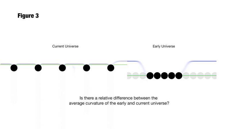

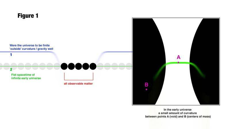

Essentially with this question I am trying to understand how a densely packed universe, full of energy, does not warp spacetime any more than the one we see today. (@Chronos looking at you for the actually density numbers)
I assumed (likely incorrectly) that the light emitted at the CMB was at a lower gravitational potential than when it finally reaches us now.
Okay, now I’m going to embarrass myself with some diagrams drawn up in photoshop. (@Ibix I’m going to go for the GR counter point, don’t hold your breath)
Figure 1 shows the early universe. Matter is closely packed. The gravity wells of said matter are also packed together. Space-time is, on average, pretty flat within this soup of matter. If the universe was finite, and had an edge where this dense matter gave way to ‘empty’ space, the gravitational well would be pretty sever.
Figure 2 shows the current universe. Matter is spread out. Gravity wells plateau to increasing smaller curvature over the large distances, more closely approximating/reaching idealized ‘empty’ space. Space-time is, on average, pretty flat within this spread out matter.
Figure 3 shows the two states in relation. Making the 'empty' space-time curvature of a theoretically finite universe commonality. Though both states have an on average flatness, the early universe exists at a much lower gravitational potential than the current universe. The finite universe line is not really important, but does illustrate the idea better graphically.
I read about early galaxies being better at making stars, potentially because of the higher density of the early universe, which sent me down this line of questioning.
https://mcdonaldobservatory.org/news/releases/20151119
Ok, rip it up team.
I’m not out to prove anything. Just want to get my thoughts straight. Thanks for bearing with me, I really appreciate this community... even if I don't always understand it.

The problem with figure 1 is that your blue line "outside matter" doesn't exist even in principle. You are effectively trying to imagine what a universe full of uniform matter would look like if it weren't full of uniform matter. As I asked in another context recently, what colour is a sheep that is completely black and completely white at the same time? The only possible answer is "that makes no sense". A place outside the matter distribution in a universe completely filled with a uniform matter distribution is a concept that makes no sense.
Figure 2 has the same problem. If your figure 1 is a diagram of a sheep that is completely white and completely black, figure two is a diagram of one that is completely brown and completely white at the same time.
Hence your figure three doesn't work. The blue lines that you've joined together don't represent anything that you can define or measure. So, in the sheep analogy, you are sticking together a black and white sheep and a brown and white sheep and saying they're different because the white is the same but the other colour is different - ignoring the fact that neither sheep could actually exist.
Essentially all of this stems from you ignoring me when I said you couldn't define a potential. You are trying to equate potentials (that can't exist) at a point (that can't exist) outside a matter distribution in a universe completely filled with a uniform mass distribution, and hoping to get coherent sense out of the resulting mess.
If you want to reason about GR, rather than rote learn some facts, you have to learn the maths. Trying to guess how it works based on vague verbal descriptions won't produce a clear enough understanding - as you have just demonstrated.
That's not what you're showing. You're showing matter closely packed in a small region, surrounded by vacuum. That's not what the early universe was like. It had matter closely packed everywhere.
No, it wasn't. Space was flat, but that's not the same as spacetime being flat.
It doesn't. See above.
D.S.Beyer said:
Ok, rip it up team.
Your basic picture of the universe is wrong. See above.

Bernard OByrne said:
The effect of gravity on photons was not appreciated when the original calculations were done. It is now known that light is red shifted when it climbs out of a gravity well.
The early universe was far denser than it is today - an immense gravity well. While the red shift due to the photons climbing out of this well would be tiny compared with the red shift caused by the relative motion of the light source and ourselves I feel it could change the results of many calculations sufficiently to give a slightly changed picture of our universe
That the universe was denser does not mean it was deeper in a gravity well. To talk about the depth of a gravity well you need to have a reference point that is somehow higher up. In the early universe, everything was denser everywhere, so there was no place far away from any mass that you could stand at and make a statement about how deep the entire rest of the universe was in a gravity well. For the same reason, there was no global well for the light to climb out of just because the universe underwent expansion.
There are local gravity wells associated with overdense regions in the universe, but they don't evolve without dark energy, and the influence of the latter is known and appreciated as the Sachs-Wolfe effect, already discussed in this this thread, e.g. in post #21 above.
Likes Bernard OByrne and PeterDonis
Being new to this type of communication, I don't know how to register that I 'like' your post.
You should see a "Like" button near the bottom right of every post.
Thanks so much for your response, Bandersnatch.
Not being a 'proper' cosmologist, I don't have the background to research my ideas, and perhaps I do not express myself very well.
I was aware that black holes were considered as a candidate for the dark energy, but were rejected. I was not aware of the difference between MACHO and WIMP objects, but find it interesting that that you say that 'WIMPs were simply found to have less problems in the end'. Forgive me, but 'less problems' seems to me to be an inadequate reason for incorporating them into the theory. There are still problems, and I was trying to resolve the dilemma to my own satisfaction.
Perhaps I am obsessed by the idea that a fundamental rethink is necessary to formulate a coherent theory.
As regards the gravity well, I realize I am not on a firm footing. I was considering that in our current position, billions of years after the light was emitted the ambient gravity is considerably less than it was then, which suggested to me that the light did have to climb out of a well. I acknowledge that I have nothing concrete to back up my feeling, but seeing the continued failure to come to a coherent theory - and the adding of new concepts to bring the approximations closer to observed facts - I was looking for a way to simplify the theory.
I freely admit that I do not (yet) 'get' your argument that there was no gravity well - it still seems to me that going from a very dense area to a much more sparse area would require energy - I see I have a long way to go.
Thanks again.
Not necessarily. The problem is that you haven't specified the movement of the components of the system. If you start with a dense region, but the particles in that region are all moving away from one another, then it will expand. It can even lose energy as it does so because those particles may slow down as they move away from one another.
But energy isn't conserved on cosmic scales in any event. So whether or not energy is required is moot: it can't be, because energy isn't conserved globally.
