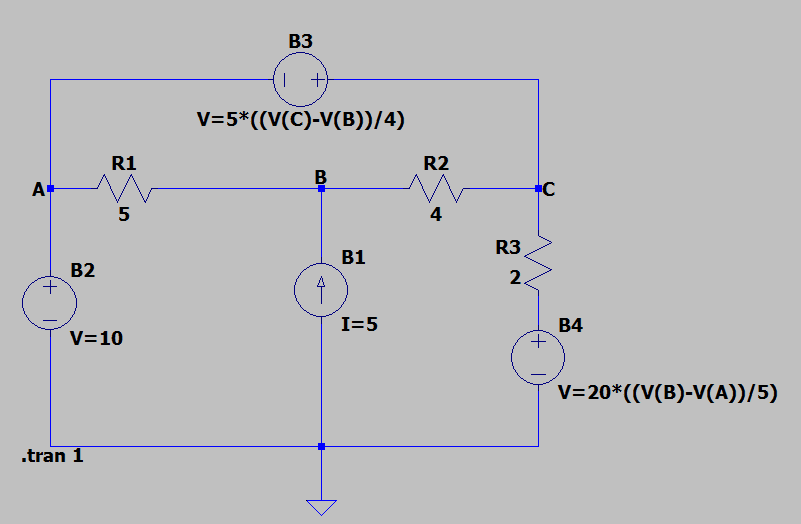

Using KVL find the current through the resistors and Power of the dependent current source.
nil
Hi all,
I was trying to solve this but I'm stuck as you can see in my notes below:
Using simulator the I1=3.125 A | I2=-1,857 A | I3=4,375 A and Power of the dependent current source = -46.875 W
Any idea, what could be wrong ?Thanks.
