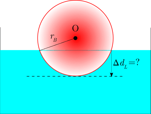

I draw a sketch of the diagram to the right.
The body has a radius of ##r_B = 0.2## m.
The volume of the body is given by ##V_B = \frac{4}{3}\times \pi \times 0.2^3 = 0.034\;\text{m}^3##.
The mass of the body : ##w_B = \rho_B V_B = 400\times 0.034 = 13.37\,\text{kg}##.
Hence the mass of the liquid displaced : ##\Delta m_L = 13.37\, \text{kg}## . (Law of floatation can also be "read off" as ##m_B = \Delta m_L##)
The volume of liquid displaced : ##\Delta V_L = \frac{\Delta m_L}{\rho_L} = \frac{13.37}{1000} = 1.34\times 10^{-3}\,\text{m}^3##.
This is the volume of the sphere below the blue line inside the water, as shown to the right.
Question is, how to connect the volume of liquid displaced ##\mathbf{\Delta V_L}## to the volume of the body ##\mathbf{V_B}## ?
I could proceed no further. Any help would be appreciated.

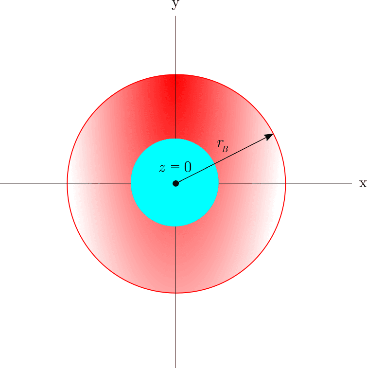

You need to find an expression for the volume of a spherical cap, which can be done with a volume of revolution.
Any clue as to finding the volume of a spherical cap?
Position the sphere such that its centre is at the origin of a Cartesian coordinate system. With ##z=0##, the projection onto the ##x##-##y## plane is ##x^2 + y^2 = r_B^2##. You can re-arrange that for ##y^2##, and then evaluate the integral$$V_{cap} = \int_{r_b - d_l}^{r_b} \pi y^2 dx $$

I am through with the first of the solutions to, what seems to me still, a fairly tricky problem. The following method is the simplest for which I thank https://www.physicsforums.com/members/etotheipi.664237/ . I will present the other two solutions, one using spherical (polar) coordinates and the other using the idea of solid angles as soon as I can help it. Thank you for your discussions and help.
Solution 1
(using the method of cartesian coordinates to find the volume of the spherical cap) :
I begin by drawing a bird's eye-view of the situation. The sphere is seen from above. It's projection on to the x−y plane is a circle with the equation ##x^2+y^2=r_B^2##.The blue part of the sphere (-z) is where it is submerged in water to a depth of ##d_L## and is at the lowest. It is the volume of this part that I am interested in. Of course, there is an equally large "cap" on the top side of the sphere (+z) which is red and now shown.
The volume of the spherical cap (under water) can be found by "revolving" this circle about the z axis. The volume of the cap : $$V_{cap} = \pi \int_{r_B - d_L}^{r_B} y^2 dx = \pi \int_{r_B - d_L}^{r_B} (r_B^2 - x^2) dx = \pi \left[r_B^2 x - \tfrac{x^3}{3} \right]_{r_B-d_L}^{r_B} = \pi \left[\cancel{r_B^3} - \tfrac{r_B^3}{3} - r_B^2(\cancel{r_B} - d_L) + \tfrac{{\left(r_B-d_L \right)}^3}{3}\right]$$ $$= \pi \left[ \cancel{-\tfrac{r_B^3}{3}} + \bcancel{r_B^2 d_L} + \cancel{\tfrac{r_B^3}{3}} - \bcancel{r_B^2 d_L} + r_B d_L^2 - \tfrac{d_L^3}{3} \right] = \pi d_L^2 \left[r_B - \tfrac{d_L}{3} \right] = \pi \tfrac{d_L^2}{3}(3r_B - d_L)$$.

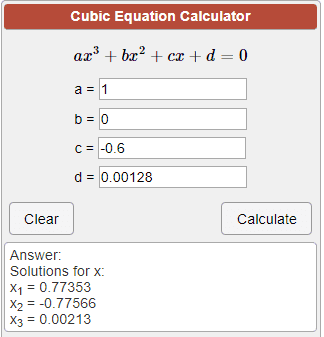

It is reassuring at this stage that my answer thus far matches that of the Wikipedia article posted above. I only put the picture alongside and the answer. This answer is the same as mine for ##r_B\rightarrow r## and ##d_L\rightarrow h##.
From my calculations earier (post#1), we had the volume of the sphere under the liquid given by ##\Delta V_L = V_C = 1.34\times 10^{-3} = \tfrac{\pi d_L^3}{3} (0.6-d_L)\Rightarrow d_L^3 -0.6 d_L + 1.28\times 10^{-3} = 0##.
An online solution to the above cubic equation yielded three answers of which only one is feasible to the problem above given the radius of the sphere is ##r_B = 0.2##m.
The answer is ##\boxed{\color{blue}{d_L = 0.00213\, \text{m} \approx 0.2\, \text{cm}}}##.
Do you think this answer is right?
For one, given the radius of the sphere (20 cm) and density (400 kg/m##^3##), less than a cm is submerged inside the liquid, which looks unreasonable.

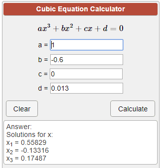

Those 2 mm can't be the correct answer.
If the density of the sphere is about 40% of the density of water, about 40% of its volume should be submerged, in order to achieve buoyancy.
Something like 18 cm should be close to the correct answer.
Your calculated volume of liquid displaced in post #1 is incorrect.
It should be 0.01337 m^3?

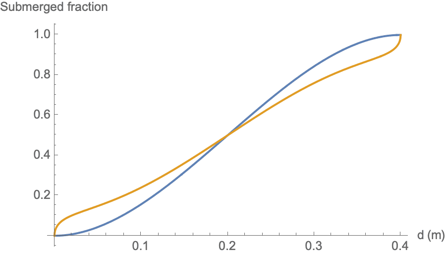

If ##\theta## is the half-angle of the cone and d is the submerged depth, I get $$\cos{\theta}=\frac{R-d}{R}$$and a submerged volume of $$V=\frac{4}{3}\pi R^3\frac{\theta}{\pi}-\pi[R^2-(R-d)^2]\frac{(R-d)}{3}$$
Is this not correct?
In order to have only one variable, it can be changed to $$V=\frac{4}{3}\pi R^3\frac{\cos^{-1}(\frac{R-d}{R})} {\pi}-\pi[R^2-(R-d)^2]\frac{(R-d)}{3}$$but in this form it less useful than the other equation for solving the force balance equation for ##d##.
As to whether it is correct, I have to say that it is trying to be correct but is not quite there. Shown below is a plot of the submerged volume fraction as a function of depth d. The blue line is the expression from OP's post #22 and the brown line is the expression above normalized to the sphere's volume. The two curves match only the end points and the midpoint. I coudn't find an obvious fix; perhaps you can.
I believe the volume of the spherical sector (your first term) should be, in these variables,
$$dV_{SECTOR}=\Omega R^2 dR$$ and using the expression for solid angle previously quoted ##\Omega=2\pi\frac d R ## so $$V_{SECTOR}=\frac {\Omega R^3} 3$$$$V_{SECTOR}=\frac {2\pi R^2d} 3$$

Really you are revolving the arc defined by ##y = \sqrt{R^2 - x^2}## by one full rotation around the ##x## axis (i.e. rotating the circle defined by ##x^2 + y^2 = R^2## around the ##z## axis does nothing to the curve!). And that is, in practice, a summation of cylindrical volume elements.
If d is the sagittal depth shouldn't ##\Omega=0## for d=0 and ##\Omega=2\pi## for d=R ?

  • #34
brotherbobby said:
The volume of liquid displaced : ##\frac{13.37}{1000} = 1.34\times 10^{-3}\,\text{m}^3##.
brotherbobby said:
##\tfrac{\pi d_L^3}{3} (0.6-d_L)\Rightarrow d_L^3 -0.6 d_L + 1.28\times 10^{-3} = 0##.
Check the exponents in both.
  • #35
kuruman said:
I get close to 18 cm. Check that your equation of force balance obeys Archimedes's principle $$\rho_{sphere}V_{sphere}=\rho_{water}V_{cup}.$$
Thank you and apologies. Of course those two did not match for me and I have since corrected my results. I will do those corrections in a different post which will appear towards the end.
