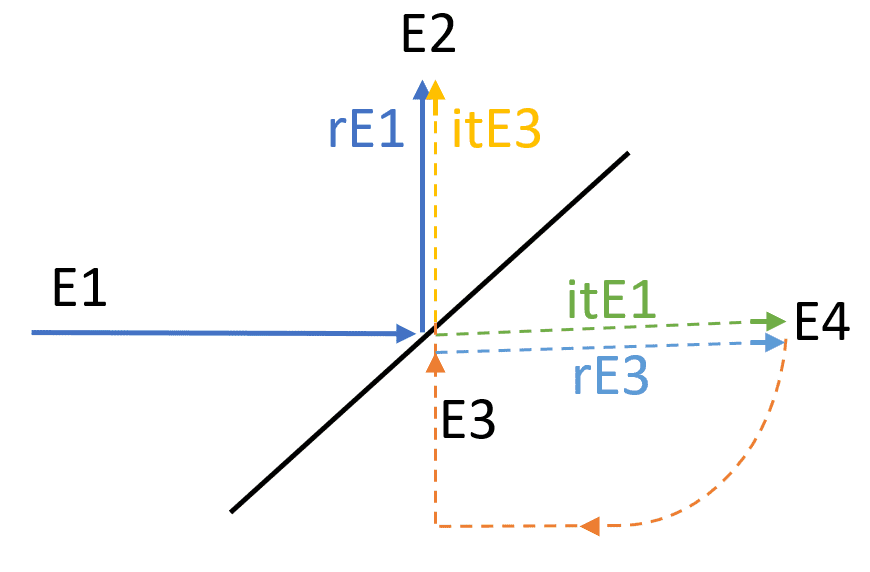

I am trying to understand how the three equations below were solved simultaneously to get to the equation shown below. This equation was presented in a paper and it relates the input and output fields of a Fabry-Perot etalon.
This is the equation I am trying to derive:
$$\frac{E_{2}}{E_{1}}=\exp\left[i\left(\pi+\varphi\right)\right]\frac{\tau-r\exp\left(-i\varphi\right)}{1-r\tau\exp\left(i\varphi\right)}$$
Here are three equations:
$$E_{2}=rE_{1}+itE_{3} \tag{1}$$
$$E_{4}=rE_{3}+itE_{1} \tag{2}$$
$$E_{2}=\tau\exp\left(i\varphi\right)E_{4} \tag{3}$$
I started by substituting Eqn. 3 into Eqn. 2,
$$\frac{E_{2}}{\tau}\exp\left(-i\varphi\right)=rE_{3}+itE_{1}, \ \therefore E_{3} = \frac{1}{r}\left[\frac{E_{2}}{\tau}\exp\left(-i\varphi\right)-itE_{1}\right],$$
and then I substituted this result into Eqn. 1 to get
$$E_{2}=rE_{1}+it\frac{1}{r}\left[\frac{E_{2}}{\tau}\exp\left(-i\varphi\right)-itE_{1}\right]$$
$$\left[1-\frac{it}{\tau r}\exp\left(-i\varphi\right)\right]E_{2}=\left[r+\frac{t^{2}}{r}\right]E_{1}\Rightarrow\frac{E_{2}}{E_{1}}=\frac{\left[r+\frac{t^{2}}{r}\right]}{\left[1-\frac{it}{\tau r}\exp\left(-i\varphi\right)\right]}.$$
After applying the complex conjugate I got
$$\frac{r+\frac{t^{2}}{r}+i\left[\frac{t^{3}}{\tau r^{2}}+\frac{t}{\tau}\right]\exp\left(-i\varphi\right)}{1+\left(\frac{t}{\tau r}\right)^{2}\exp\left(-i2\varphi\right)}.$$
I couldn't manipulate this further to get to the desired equation. Am I on the right track? :oldconfused: :
Also, how did the authors introduce the ##\pi## into the argument of the exponential?
Any help is greatly appreciated.

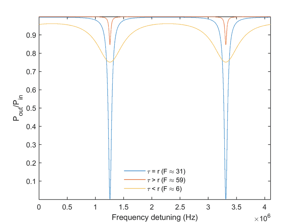

The reason I'm using this paper is that it takes into account the intrinsic resonator losses (##\tau = 1-\text{loss}##). Your link and also Hecht (chapter §9) do not take this loss into consideration. I am trying to simulate fiber ring resonators where this loss is very important (unlike the simple air-spaced Fabry-Perot etalon).
In this paper, they get the following as the transmission:
$$\frac{\tau^{2}-2r\tau\cos\varphi+r^{2}}{1+r^{2}\tau^{2}-2r\tau\cos\varphi}.$$
The standard equation in most textbooks (no losses) is:
$$\frac{2r-2r\cos\left(\varphi\right)}{1+r^{2}-2r\cos\left(\varphi\right)} = \frac{F\sin^{2}}{1+F\sin^{2}},$$
where ##F=\frac{4r}{\left(1-r\right)^{2}}## is the coefficient of Finesse (Hecht erroneously defines ##F=\left(\frac{2r}{1-r^{2}}\right)^{2}##).

Hi @Charles Link
Could you please describe what exactly are the 7 E-fields that need to be considered in a Fabry-Perot etalon? I looked at the figure from the MIT lecture notes and also your own article, but it wasn't clear to me why there has to be 7 distinct fields.
Here is a diagram I made of the ring resonator that models the coupler as a simple beamsplitter:
242240
As you can see, there are at most 6 fields. I believe we can describe ##E_3## as the intracavity circulating field after one round-trip. In the paper that I've linked to, they define the intrinsic cavity loss as being related to the ratio ##E_2/E_4##. More appropriately I think it is related to ##E_3/E_4##. Actually, in another paper the very same authors use this latter definition:
$$E_{3}=\tau\exp\left(i\varphi\right)E_{4}.$$
Their derivation might be a bit sloppy but I think it is alright as a first-order approximation. My problem is mainly in being able to verify the algebra. I am currently looking at Siegman's book to see if I can derive a similar expression. I need an equation for transmission that explicitly contains ##r## and ##\tau##. This is very useful for simulating the behavior of the three coupling regimes. For example, here's what I get when I plot their equation (from the paper I've linked) for the three different cases:
242228
While this isn't a rigorous treatment, I was able to use it to loosely fit some experimental data I collected from a ring cavity I built.

Hi @Charles Link
Thanks for that.
So, using the new equation from my last post I was able to get very close to the required equation (there most likely was a typo in the paper).
The set of simultaneous equations is now:
\begin{cases}
E_{2}=rE_{1}+itE_{3} & (1)\\
E_{4}=rE_{3}+itE_{1} & (2)\\
E_{3}=\tau\exp\left(i\varphi\right)E_{4} & (3)
\end{cases}
We substitute (3) into (2) and then put the result into (1). After some simplification the ratio becomes:
$$\frac{E_{2}}{E_{1}}=\frac{r-\tau\left[r^{2}-t^{2}\right]\exp\left(i\varphi\right)}{1-\tau r\exp\left(i\varphi\right)}$$
Using the fact that ##r^2 + t^2 = 1## we can rewrite "##r^{2}-t^{2}##" as "##2r^{2}-1##" and so the the expression becomes:
$$\frac{r-\tau\left[2r^{2}-1\right]\exp\left(i\varphi\right)}{1-\tau r\exp\left(i\varphi\right)}=\frac{r\boxed{- 2\tau r^{2}\exp\left(i\varphi\right)}-\tau\exp\left(i\varphi\right)}{1-\tau r\exp\left(i\varphi\right)}$$
The term inside the box above is the only problem now. The correct answer (given in my first post) doesn't contain this term:
$$\boxed{\frac{E_{2}}{E_{1}}=\exp\left(i(\pi+\phi)\right)\frac{\tau-r\exp(-i\varphi)}{1-r\tau\exp\left(i\varphi\right)}=\frac{r-\tau\exp\left(i\phi\right)}{1-r\tau\exp\left(i\varphi\right)}}$$
Do you know why they omitted this term? Or perhaps there is a problem with my derivation? :oldconfused:
Any suggestions would be greatly appreciated.
