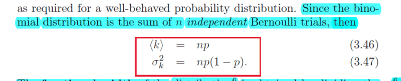

I am not understanding, <k>.
The book gives <k> = np
k is the number of sucesses which we want in n independent Bernoulli trials.
So, does <k> mean average number of sucesses we can get in the n independent Bernoulli trials?
Is it that in the 1st trial we get 0 success, in the 2nd trial we get one success, in the 3rd trial we get 0 one success ; i.e. we took the outcomes of n trials, sum them and divide them by n. This gives the average number of success in n trials.<k> = ## \Sigma_{k=0 } ^ { n} {k P(k,n)} ##, where P(k,n) = ##\binom n k p^k (1-p)^{(n-k)}##
But, then how does <k> = np?
I thought of Binomial distribution as the probability of getting k sucesses out of n independent Bernoulli trials.
I am not understanding how to get the following understanding from the above understanding:
The Binomial distribution is the sum of n independent Bernoulli trials.
Let’s associate a random variable with each trial. We have n random variables ## X_1, X_2, …, X_n ##.
Now, these variables are outcome of each corresponding trial.
When the outcome is success, the variable has the value 1 and when the outcome is failure , the variable has the value 0.
Then, k could be written as the sum of these variables.
So, <k> = ## < X_1 + X_2+…+X_n> ##
Since the variables are independent, ## < X_1 + X_2+…+X_n> = < X_1> +<X_2> +… + <X_n>##
Now,## <X_n> = 1*p + 0*q = p##
So, <k> = np.
I derived this with the help of the following idea:
But, I do not know why I should take the help of this idea.
Why is it necessary to know that <k> = np?
Does it have any physical significance? I mean is there anything here to understand or is this just a mathematical calculation?

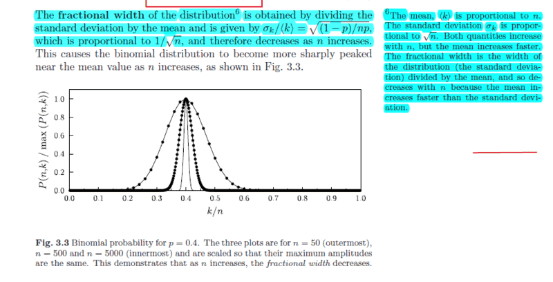

Is there anyway to visualize standard deviation also? Or is it, too, just a mathematical calculation?
How does it matter whether the standard deviation for a given data is more or less?
I have not understood the following part.
Will you please put some light upon the following:
Why is it said that the standard deviation tells us the width of a distribution?
It is the expected number of successful trials.
If you compute the sum, you will find ##np##. The easier way of seeing it is by linearity of expectation value. Each trial gives an expectation value of ##p## and you have ##n## trials.
It is a property of the distribution, just as its variance. Whether it is necessary to know it or not depends on what information you want to extract from the distribution.
The standard deviation (or more conveniently, its square - the variance) is a measure of the spread in the distribution, i.e., how much the result will typically differ from the expectation value.
Because that is exactly what it does.
You can have two different distributions with the same mean but different standard deviations, and it is handy to have some (at least crude) way to speak about some of their differences in numerical terms. If one distribution is more "spread out" than another it has a higher standard deviation. The simplest example would be when comparing the two distributions Unif(-1,1) and Unif(-5,5). The first distribution describes outcomes that are uniformly distributed between -1 and +1, while the second between -5 and +5. If you draw a random sample from the first distribution your values would always lie sprinkled between -1 and +1, but a sample from the second distribution will have some outcomes near +5 or -5.
The fact that the mean increases linearly in ##n## but the standard deviation increases like ##\sqrt{n}## is what makes the world possible! Looking at averages ##\bar{X} =(1/n) \sum_1^n X_i##, if the individual random terms have mean ##\mu## and standard deviation ##\sigma##, the average has mean ##\mu## but standard deviation ##\sigma/\sqrt{n}##. For very, very large ##n## the average ##\bar{X}## is "almost non-random", very much like a deterministic quantity. That is why Physics works, and is why life is possible in the universe: the huge number of atomic particles undergoing their random motions look "organized" on the macro scale of everyday life. We don't see all the underlying randomness, and that is good because it allows events to happen predictably; it makes the cells in our bodies behave as they should and it makes it possible for the world to exist.
So, <k> = np.
When you ask for the number of heads in 20 coin tosses, you are asking for the number of heads on toss 1 + the number of heads on toss 2 + ... + the number of heads on toss 20. For each toss that number is either 0 (if you get a tail) or 1 (if you get a head).
As to why it is necessary to know ##\langle k \rangle = np##: well, that just tells you the expected number of "successes". If I toss a pair of fair dice, the probability of getting a '7' on any toss is p = 1/6. If I toss a pair of dice 600 times I would expect to get a number of '7's near 600/6 = 100. In any actual experiment (consisting of tossing dice 600 times) the number of '7's will likely be different from 100 most of the time, but not all that different: sometimes higher, sometimes lower but hovering around 100. If you were asked to bet on the number of '7's in 600 tosses, the number 100 would be your best guess. Over the long run you would win the bet more often by picking 100 than by picking any other number. (Admittedly, you would not win very often but you would win even less often if you picked a number other than 100.)
Likes Pushoam

How best our guess would be is determined by the fractional width of the distribution i.e.## \frac{\sigma_k}{< k>}##. Right? The smaller the fractional width, the better the guess.
