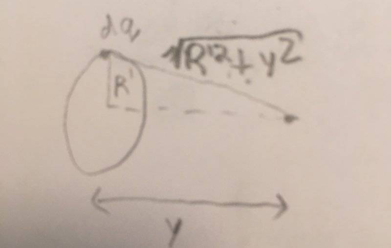

a)recall that electric potential is a scalar quantity. For a circular ring of radius, R', carrying charge, Q, what is the electric potential at a height,y, above the center of the ring?

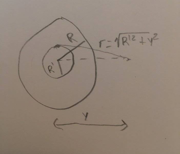

b)Use your above answer to determine the electric potential at a height,y, above the center of a uniformly charged disk of radius, R.

a)V=q/(4πε0r)
dv=dq/(4πε0)
See ring.jpg attached
V=∫dv=∫dq/(4πε0)=[1/(4πε0r)]∫dq=q/4πε0r=q/4πε0(R'2+y2)1/2
b)See disk.jpg attached
V=kq/(R'2+y2)1/2
dV=kdq/(R'2+y2)1/2
(dq/Q)=(2πR'dr/πR2)→dq=2QR'dr/R2
The limits on the below integral are from 0→R until stated differently
V=∫dV=∫(k2QR'dr)/[R2(R'2+y2)1/2]=(kQ/R2)∫2R'dr/(R'2+y2)1/2
V=q/(4πε0r)
a)V=q/(4πε0r)
dv=dq/(4πε0)
V=∫dv
=∫dq/(4πε0)
=[1/(4πε0r)]∫dq
=q/(4πε0r)
=q/(4πε0(R'2+y2)1/2)
This result (Part a) looks good. Remember that the charge, Q is the total charge on the disk, whereas, q, will become the portion of the total charge on a thin ring,
Also, you should enclose in parentheses the whole of any denominators in the above expressions. I added those in RED above.
V=q/(4πε0r)
V=q/(4πε0(R'2+y2)1/2)
V=kq/(R'2+y2)1/2
dV=kdq/(R'2+y2)1/2
Any r as in dr you have in this part should be R' and dR'

The u-substitution looks fine, but your integration result doesn't look so good.
Also, after finding the antiderivative (indefinite integral) I find it handy to switch back to the original variable(s) and then substitute the limits of integration: Less chance for mistakes.

Before integrating, let's see what the integral is !
∫2R'dr/(R'2+y2)1/2
becomes (without limits for now)
##\displaystyle \int \frac{dU}{\left( U \right)^{1/2}} ##
but you might be better off writing it as:
##\displaystyle \int {U ^{-1/2} \ } dU ##​
You made an error with the integration.
Added in Edit:
Never mind. the integration looks fine. DUH !
after taking integral:
(KQ/R2) [u1/2]evaulated from y2→R2+y2=(KQ/R2)[(R2+y2)-y]
Well, that last result should be: ##\displaystyle \ V(y)=\frac{2k Q}{R^2}\left( \sqrt{R^2+y^2\,} - y \right) ##
(Fixed a missing factor of 2)
c)if y>>R, use the binomial expansion (keeping terms up to and including R2/y2 ) to show that the electric potential now resembles that of a point charge
V=q/(4πε0r)
c) This is the part I am confused on... not sure where to start.
I know if y>>R then my above answer turns into
(KQ/R2)[y2-y] but other than that not sure where to go...
Of course we know that last statement is wrong. The potential obtained above is: ## \displaystyle \ V(y)=\frac{2k Q}{R^2}\left( \sqrt{R^2+y^2\,} - y \right) ##
The first thing to do is to manipulate the portion that depends on ##\ y\ ## to to have terms with ##\ R/y \ ##.
A reasonably clean way to do this is to define a new (temporary) variable, ##\ u\,.\ ## Let ##\displaystyle \ u = R/y\,,\ \text{ so that } \ R = u\cdot y \,.\ ##
Notice that if y >> R, then 1 >> u.
You should get ## \displaystyle \ \left( \sqrt{R^2+y^2\,} - y \right) = \left( \sqrt{u^2y^2+y^2\,} - y \right) \,.##
Now, factor out ##\ y \ ## from the expression on the right side of the equation.
"Binomial expansion of what?", you may be asking?
Look at Wikipedia: Newton's generalized binomial theorem .
## \displaystyle \sqrt {x+1} = 1+{\frac {1}{2}}x-{\frac {1}{8}}x^{2}+{\frac {1}{16}}x^{3}-{\frac {5}{128}}x^{4}+{\frac {7}{256}}x^{5}-\cdots ##
Plug in ##\ u^2 \ ## for ##\ x\ ## and see what you get.
