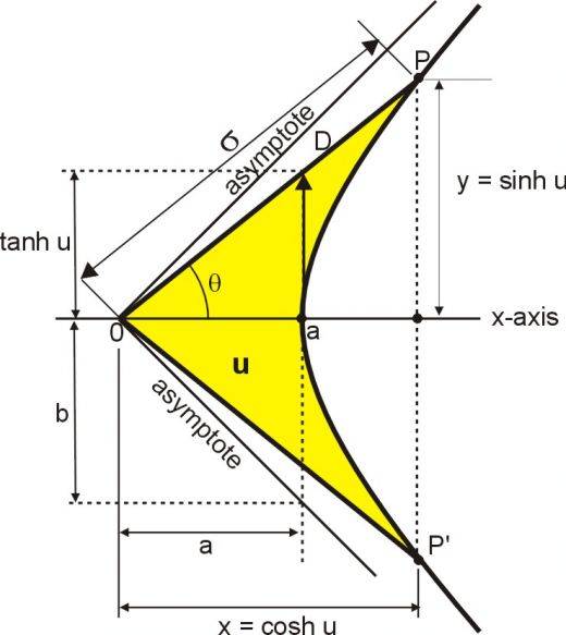

Now, I have tried, tried and tried and I cannot get from A) to B)
In the figure posted we have the t-axis vertical and the x-axis horizontal and this is a time-like representation:
In this equation that starthaus presented:
c2t2 - x2 = [itex]\tau^2[/itex]
[itex]\tau [/itex] should be the t intercept at x = 0
any point on the hyperbola should be represented by the parametric equations of
x = [itex]\tau[/itex]sinh [itex]\phi[/itex] and
t = [itex]\tau[/itex]cosh [itex]\phi[/itex]
where tanh-1 [itex]\phi[/itex] = x/t for any point (x, t) on the hyperbola
How do I make the connection?
I think that should be:
x = c[itex] \tau[/itex] sinh [itex]\phi[/itex] and
ct = c[itex] \tau[/itex] cosh [itex]\phi[/itex]
where tanh [itex]\phi[/itex] = x/(ct) = v/c = [itex]\beta[/itex] for any point (x, ct) on the hyperbola.
(not tanh-1)

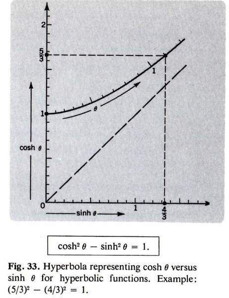

Fredrik said:
[tex]v^2=\tanh^2\phi=\frac{\sinh^2\phi}{\cosh^2\phi}=\frac{\cosh^2\phi-1}{\cosh^2\phi}=1-\frac{1}{\cosh^2\phi}[/tex]
[tex]\frac{1}{\cosh^2\phi}=1-v^2=\frac{1}{\gamma^2}[/tex]
[tex]\cosh\phi=\gamma[/tex]
[tex]\sinh^2\phi=\cosh^2-1=\gamma^2-1=\frac{1}{1-v^2}-\frac{1-v^2}{1-v^2}=\frac{v^2}{1-v^2}=\gamma^2v^2[/tex]
[tex]\sinh\phi=\gamma v[/tex]
What part of that is impossible for you to understand? The third and fifth lines are the results that take you from A) to B).
Explanation of the equalities:
First line: 1) Definition of rapidity ([itex]\tanh\phi=v[/itex]). 2) Definition of tanh. 3) The identity [itex]\cosh^2x-\sinh^2x=1[/itex], which is easy to derive from the definitions of sinh and cosh. 4) For all real numbers A,B with A non-zero, we have (A+B)/A=1+B/A.
Second line: 1) The result from the first line. 2) Definition of [itex]\gamma[/itex].
Third line: 1) The square root of the result in the second line.
Fourth line: 1) The identity [itex]\cosh^2x-\sinh^2x=1[/itex] again. ([itex]\cosh^2[/itex] should of course be [itex]\cosh^2\phi[/itex]. I left out the variable by accident). 2) The result from the third line. 3) Definition of [itex]\gamma[/itex] and the fact that 1=A/A for all non-zero real numbers A. 4) For all real numbers A,B,C with C non-zero, we have A/C+B/C=(A+B)/C. 5) Definition of [itex]\gamma[/itex].
Fifth line: 1) The square root of the result in the fourth line.

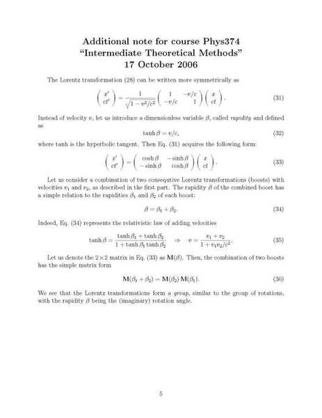

I'll download it to paper and with my calculus book that goes into hyperbolic functions and their derivatives I will pour over it until it sticks in my brain.
Below, I have posted a part of a lecture that sort of proves it, too but this author just made a wild a-- guess which turns out to be true (equation 32) or [itex]\beta = v/c[/itex] which is just a WAG. Nothing like knowing the answer before you take the test. How do you think we doctors got through medical school? Certainly not on out of genius.
I wouldn't describe (32) as a guess. It's the definition of rapidity. (The same one I'm using, except that I'm calling it [itex]\phi[/itex] instead of [itex]\beta[/itex]. I don't like calling it [itex]\beta[/itex], because [itex]\beta[/itex] is often defined as v/c). Of course, when it's presented this way, it looks like we were just lucky that the definition turned out to be useful.

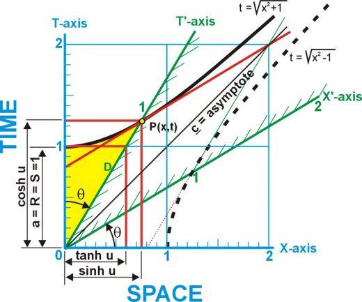

To yiuop and Fredrik -
Using the equations [itex](ct)^2 - x^2 = \tau^2[/itex] I KNOW there has to be a more direct and intuitive way to prove the hyperbolic assertions.
Using the timelike diagram where the ct axis is up and down and the x-axis ls the left and right, [itex] sinh \vartheta = x/\tau [/itex] and [itex] cosh \vartheta = ct/\tau [/itex] there has got to be a way of working [itex] v [/itex] and [itex] c [/itex] into this.
[itex] x = \tau sinh \vartheta [/itex] and [itex] t = \tau cosh \vartheta[/itex]
[itex] tanh \vartheta = x/t [/itex]
[itex] \vartheta = arctan x/t [/itex]
Now, let's get from [itex] x/t[/itex] to [itex] v/c [/itex]
This is the equation of a specific hyperbola in the diagram, so it's not a good starting point if you want to find a result that's valid for all events in the diagram.

Perhaps we should start with two images:
Source: http://hubpages.com/hub/Hyperbolic-Functions
Maybe this is a place to start (using c=1 as recommended by Fredrick :wink: ).
Passionflower - I have seen those diagrams at hubpages before
How does that get one from
Now, let's get from [itex] x/t[/itex] to [itex] v/c [/itex]?
Make the connection for me. Right now all I see is "true - true - not related."

These two images you posted (post 15) represent hyperbolas.
Source: http://hubpages.com/hub/Hyperbolic-Functions[/QUOTE]
In your thinking what do they represent in SR? There's an invariance but how do we use that?
