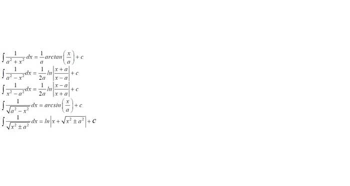

The integrals in the image are well-known, but we are not allowed to use them in the test.
I have tried to prove them using changing variable t, but I didn't succeed.
Can you show me the way?

Show us your actual work on at least one example above---whether it failed or not.
What do you mean by "not allowed to use them"? How would being able to prove them help you on a test?
The first and fourth can be done by considering the derivatives of arctan and arcsin. The second and third by factoring and "partial fractions".

For the first integral, try the trig substitution, ## x = a\cdot\tan(\theta)\ ##.

Geez I didn't think it was necessary to use a trig substitution for any of these. In the first three you can just multiply the numerator & denominator by 1/a2 & in the last two multiply numerator & denominator by 1/a.

Hey, I'm on my mobile right now so I can't see your proves for first and four integrals but for the second and third use simple fractions. I mean, you have the denominator
a^2 - x^2 = (a+x)(a-x)
So you can write
1/(a^2 - x^2) = 1/((a+x)(a-x)) = A/(a+x) + B/(a-x)
For some constants A, B which you should find easily then you just have a sum of two integrals which are two logarithms and using a basic property of log you will get what you are looking for. Third integral is analogous to this.

I think in the last one you need to use the substitution x = a⋅sec θ then dx = a⋅secθ⋅tanθ dθ etc
That works for the " - " sign. Alternatively, you can use x = a ⋅ cosh(u) .
Use x = a⋅sinh(u) for the "+" sign.
Of course the results will look a bit different: cosh-1(x/a) & sinh-1(x/a) .
