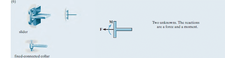

My main question is why we derive the structure matrix for a beam like the attached first picture; we assume the beam on the left on point B has no deflection? While i check this by computer analsysis program and it has an effect. Please explain in details

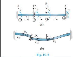

The second question is the displacement at nodal 2 has two vertical displacements and one rotation??
Why?? The logic says 1 vertical and no displacement since there is moment to prevent rotation
See picture 3 and 4 which are symbol and illustration

Regarding the first figure, it is misleading. It assumes that the beam is fixed at support B (no rotation or translation) probably as a first step in your analysis in determining stiffnesses (as in ''moment distribution'' method). Ultimately, however, that joint is released so that the member does rotate about B just like it does at C, and the deflected shape takes on a different pattern.
I don't understand the next set of figures.

for the first question, the reason of this is that we use fixed fixed assumption(that what i understand)
the second, the arrows one and two represent vertical dispacement while 3 represent roration( all free degree of freedom)
so i was confused why there any two vertical dispalcment and why rotation is allowed

Oh in question 2 the node at 2 is a slider or guided connection. In a guided connection, the beam can translate at that node, but there isn't relative rotation between beams, they must both remain 90 degrees to the slider as the joint rotates. Those forces 1 and 2 I gather are the shear forces at each end of the beams.
I am not sure of your question 3 ; in a truss, loads are axial along the members, and the members are subject to tension or compression stresses, and axial deformations only, with the stiffness of a member equal to AE/L if you need to know that.
Just thinking there may be sum confusion between a slider joint and a slider support . You have a joint that connects the 2 beams. The joint can translate and rotate, and in doing so, the beams remain at 90 degrees to the slider. If it was a slider support, the support could translate but not rotate, and the beams still stay at 90 degrees to it.
