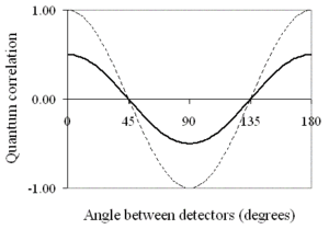

Obtain the joint probability of what particular event?2. We see the premise from step (5) applied in step (6) which adds that [itex]\pm 1[/itex] into the equation, but without it, what is the underlying relation between four expectation values the equation describes? Would it be this: [itex]E(a,b) - E(a,b') = E(a,b) * E(a',b') - E(a,b') * E(a',b)[/itex]?3. Step after (6), applying the triangle inequality to both sides. What is justification for this?
Step 6.
In that step, the idea they are using is that ##A = B + C## can also be written as ##A = B + C + D - D##. Basically we can add any term that is of the form ##D - D## since ##D - D = 0##.
There is E(a,b), E(a,b′), E(a′,b) and E(a′,b′), which I will call E1, E2, E3 and E4. Is that what you call A, B, C and D, so that: E1 = E2 + E3 + E4 - E4?

No, that is not right. Don't think about the expectation values, just the term in the square brackets of the integrand.
##\underline{A}(a,\lambda)\underline{B}(b,\lambda) = D1##
##\underline{A}(a,\lambda)\underline{B}(b',\lambda) = D2##
##\underline{A}(a',\lambda)\underline{B}(b',\lambda) = D3##
##\underline{A}(a',\lambda)\underline{B}(b,\lambda) = D4##
Then the original term can be rewritten:
##D1 - D2 = D1-D2 + D1*D3 - D1*D3##

Sure, but you prove the Bell inequality for ##E(a,b)## by using properties of ##\underline{A}(a,\lambda)##.
Consider a particular combination of expectation values, ##E(a,b)+E(a,b')+E(a',b)-E(a',b')##. In local hidden variable theory, this combination can be written as
##E(a,b)+E(a,b')+E(a',b)-E(a',b')={}##
##\int\left[
+\underline{A}(a,\lambda)\underline{B}(b',\lambda)
+\underline{A}(a',\lambda)\underline{B}(b,\lambda)
-\underline{A}(a',\lambda)\underline{B}(b',\lambda)\right]\!\rho(\lambda)d\lambda##
where ##\underline{A}(a,\lambda)##, etc., are each equal to ##+1## or ##-1##. (This is simply how we are choosing to represent the two binary values. This choice implies ##-1\le E(a,b)\le +1##.)
Do you agree with this, or not?
